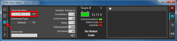

Was this your first time deploying code and opening driver station on your laptop?
If yes, be sure to follow these steps to set up your team number in there and check your joystick’s are connected properly

Did you check the steps I sent in my first post about entering your team number in driver station to match the team number you set up on the Roborio?
