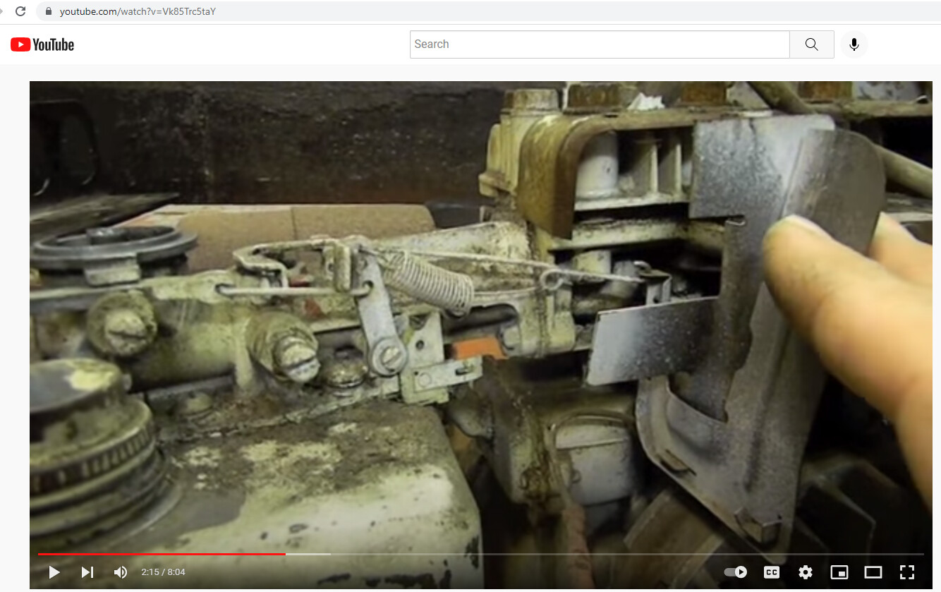

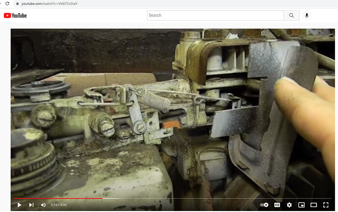

Also, RE: PID is just software… my lawn mower engine’s governor would like a word.
The software interpretation is common and usually what folks see in FRC. But it isn’t generally correct, and would require the “in FRC…” qualifier.
I also concur. However, I want to also emphasize that for a high school student to fully understand and apply it well is an accomplishment to be proud of.
It’s not easy to do well in the real world. It is however very approachable, even with only “a standard high school education”.
The provocative statement was made apparently by a student; give him a break and explain:
Governor (device) - Wikipedia.
Pneumatic : the governor mechanism detects air flow from the flywheel blower used to cool an air-cooled engine. The typical design includes an air vane mounted inside the engine’s blower housing and linked to the carburetor’s throttle shaft. A spring pulls the throttle open and, as the engine gains speed, increased air flow from the blower forces the vane back against the spring, partially closing the throttle. Eventually, a point of equilibrium will be reached and the engine will run at a relatively constant speed.
My control math is too long ago. Is this FRC team use close enough to say FRC has pneumatic/mechanical PID in some way? (Or using just springs.)
