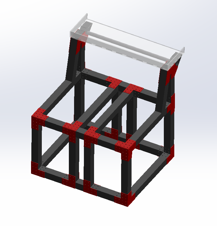

i decided to design a robot cart for my team since we were using our schools food cart as our robot cart, and well, by some calculation mistakes, my robot cart weighted around 75 kg. However im not quite sure if this is considered heavy for a robot cart like this
the rectangular tubes are 80x80 and 4032 aluminum
the whole cart is 1160x1000x760 without the upper part

For real though, the answer is “as light as possible and no lighter”. If I had to give a number, I’d say for us that usually comes out around 30 kg.
They were hollow, but i gave offset to wrong side while making the tubes. Still, they are pretty heavy.
You’re using 80mm square tubes? That’s excessive for anything like a robot cart, those are pretty much structural tubes for holding up serious weight (like, several hundred kg.) Make the cart out of more standard tube, something on the order of 50mm x 25mm or even 25mm square, with a wall thickness of 2mm or 3mm (the rough equivalent of SAE 2" x 1" tube or 1" x 1" tube with .062 or .125 wall thickness.) You overbuilt this thing so much that it’s no wonder that it’s heavy.
40" wide is way too big and wont fit through most doors.
Most carts are 24-30" max. I would lean to the shorter side like 600mm.

As one person mentioned, 40” will be too wide for many doors. ADA codes require a 32” door. If you need to transport your robot to outreach events on the cart, then fitting in an ADA compliant 32” door needs to be considered.
Some teams have trailers with ramps and they can wheel their robot cart on and off the trailer. Other teams must load their robot, cart, and pit equipment under their bus. This requires a very different style cart.
Some venues have wide aisle ways and broad corners. Other venues have narrow doors and require zero radius turns. Some venues have a ramp between the pit area and the competition area where a too heavy cart could go out of control and injure someone.
Instead of defining a “right” cart weight, I recommend getting back into the problem definition and studying how the cart will be used and what its purpose is. Writing down a Concept of Operations (CONOPS) and developing User Stories or Use Cases will help you separate the problem from the solution.

Second, I recommend first looking at several examples of what other teams are using for their robot carts. You’ll find that many don’t use a custom cart – they just get something off-the-shelf (e.g., we have this: https://www.homedepot.com/p/Everbilt-Structural-Foam-Adjustable-Hand-Trolley-690102/302883370 – weighs 9.3kg, made of plastic, folds up). This saves time: the scarcest resource in FRC. You might not have the same off-the-shelf options available, but I am certain there are some options.
Third, I generally agree with other folks in this thread, should you still choose to build your own: 50mm x 25mm x 3mm 6061 aluminum-alloy tube is roughly the right material for this job. Or wood – wood is also a good material for a robot cart.
One person should be able to lift the entire cart in a pinch. Doesn’t have to be easy, but if it’s over ~100 lbs, something is wrong. Especially if the isn’t storage for toolboxes and batteries and snacks and water bottles and the armoire.

The weight of our last made robot cart from 2023 is 22kg and is made of 30x50x2mm aluminum tube and 10mm plywood.
As mentioned earlier, I would advise first look at your requirements and wishes. And I think it makes life a lot easier if it’s less wide. You can always take a look at our blog post and if you have any questions, I am there to answer them.
