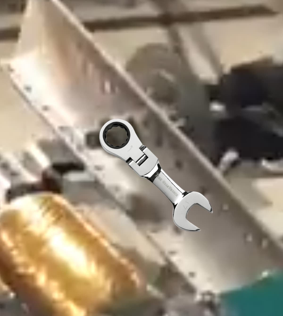

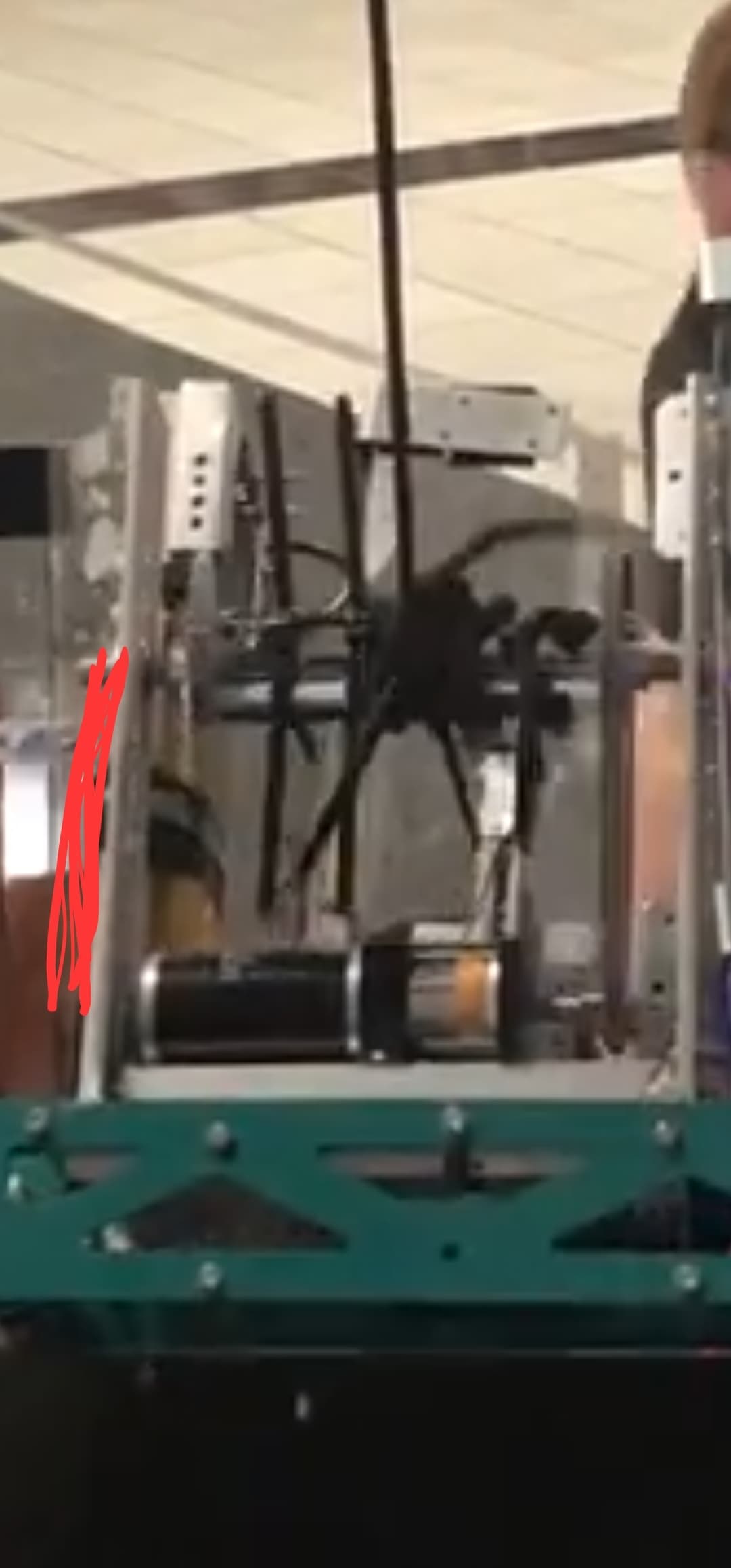

in 2020 we used literal ratcheting wrenches in order to stop our robot from slipping. I’d recommend a pneumatic ratchet if you are already using pneumatics on your robot
This video was from before we used a ratcheting 1/2 inch wrench. The shaft of the spool was 1/2 inch hex stock. Where the red is we mounted a box wrench we could unbolt to release but only let it spin one way. Worked great!
Like this… Sorry rush editing
Hopefully this makes sense. If not feel free to ask questions. I wish I had a better picture to show with it installed.
