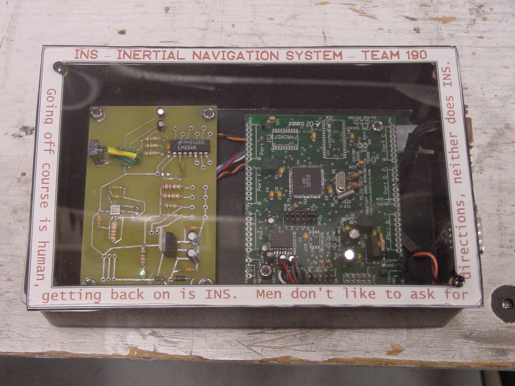

Well, I think that the description around our box explains it all. :slight_smile:
We decided against dead-reckoning, wheel counting, and line following. Why didn’t you?
– Gompei, Leading the Blind since 2003
Looks cool!
What exactly does it do?
You don’t line track, you don’t dead recog. You don’t jump over the wall and you don’t use electronics to determine where you are relative to the ramp. So how the heck does this work? :confused:

There are two ways you could do this, that i see.
One, ultra sonic sensors
Two, built a virtual court and used motor rotations to determine change and rate of change of position.
Somehow I doubt you did number 2. So what did u do?
It’s part of their CVT device…
It clocks the velocities of those via IR wheel and uses that input to determine robot postition.

But sadly enough, that box there has nothing to do with CVTs, mainly because there are currently no CVTs on the robot. :eek: But concerning those CVTs from last year, we did get “that thing finally working” for next-gen CVTs. :smiley:
I’m pretty sure they are using inertial sensors (i.e. an accelerometer) and integrating the value they receive to calculate their position. This would allow you to get quite accurate results, better than encoders, since the accelerometers can pick up wheel slippage and shoving.
I’m quite interested in knowing how you account for overall “drift” in the system… (?)
:: Nik
Military has used inertial guidance systems in the past. Subs used them to navigate under the ice caps and in deep water, before the days of GPS. ICBMs used them to. The only problem is they slowly lose accuracy. They would also have to put the robot in the exact same orientation each time so it would know where to start. I doubt it would be very acurate after a hard hit because most accelerometers only work to a certain point.

We did a few things here…the first is that we designed an Inertial Navigation System (INS for short) that used a gyro to detect our heading on the field. It also used a dual axis accelerometer (x and y axis). Based on knowing our lateral accelerations and conversions and our heading, we are able to know where exactly we are on the field at all times (well the computer knows). this was our main navagation device during autonomous mode. this system also allowed us to use “heading hold” which when utilized, maintained a straight track, and if we were pushed off course, the motors would automatically course correct. In Houston, our INS system was not working correctly (funny how in seattle the weekend before it did), but the judges were really impressed with our control setup for the operators. we were able to use 16 different preset autonomous modes, using a rotary switch, and also determine where on the field we would go using x and y coordinates on our box. we also had a few automatic functions, like restow our wings, extender, and pitch in one button push. the different autonomous modes also allowed us to see out on the field who we were up against and paired with, and make ont he fly decisions, like after we set up on the field before we stepped away from the controls, see where the opponents lined up, and make a quick change if necessary before the match. Hope that answers the questions.
