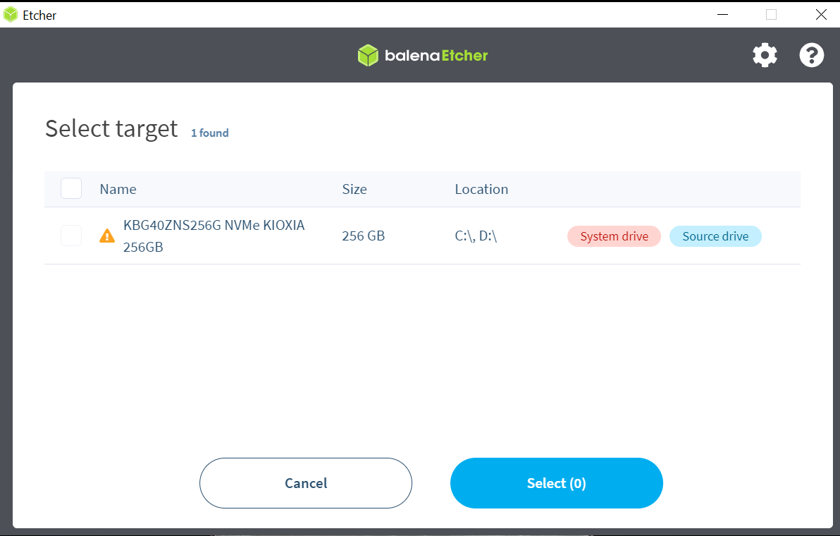

Hi! I follow the instruction but I don’t know what to do at this step.
Please tell me what to do next. Thank you!
jdaming
February 18, 2022, 7:43pm
6
It doesn’t look like your microSD card is recognized. Do you see it in Windows Explorer? How do you have it connected to your computer?

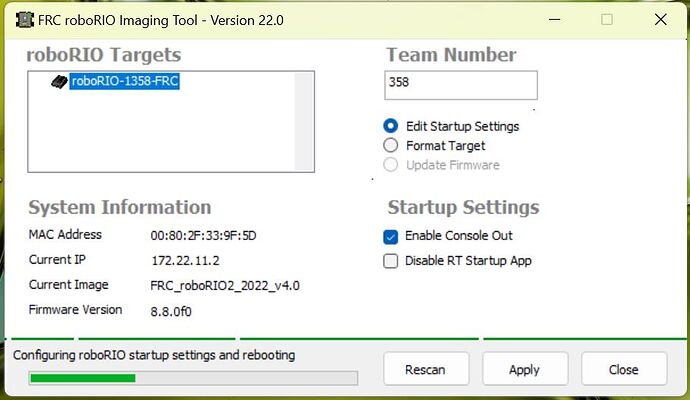

I did that and it works. How do I set the team number though? It’s 0 right now.
Now you can use the regular imaging tool just to set the team number.
Don’t select “Format Target”, use “Edit Startup Settings” instead.
ie67
November 3, 2022, 3:38pm
10
Thanks. For some reason, it would always through errors when I tried to edit startup settings. Now it works though
If the rio 2.0 had never been formatted, then it wouldn’t be able to change settings and the tool would fail (can’t talk to an operating system that isn’t there to listen).
Maybe that’s why it wasn’t working at the time?
