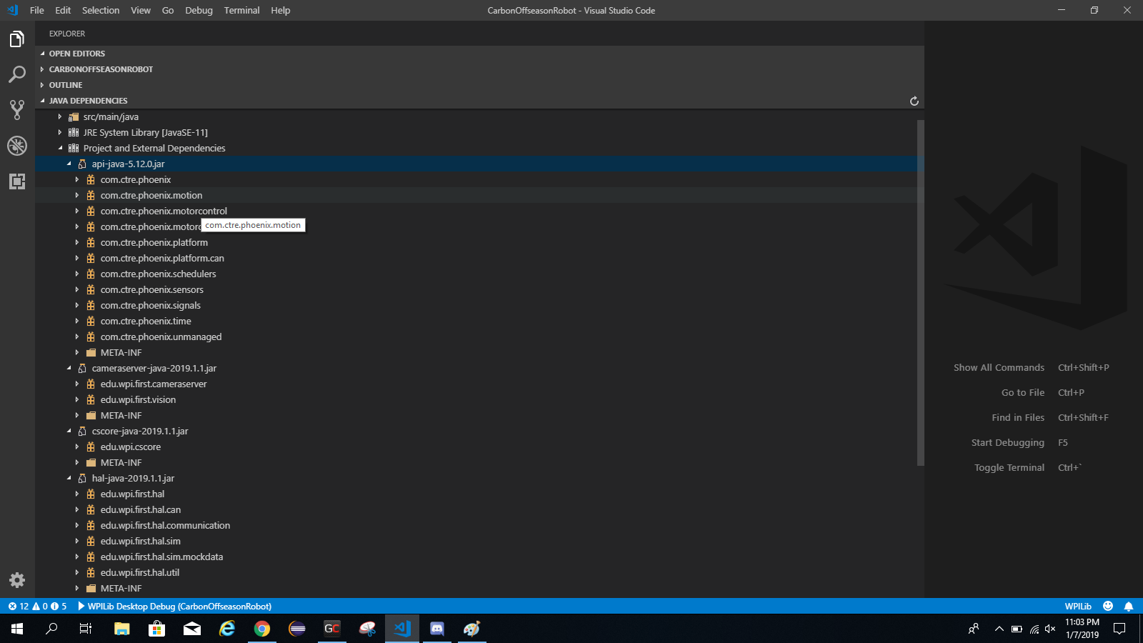

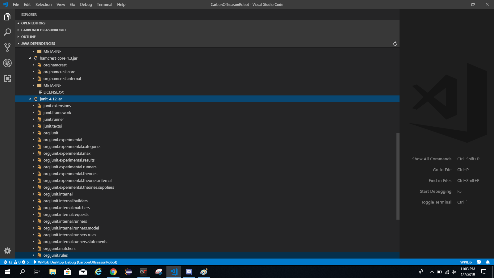

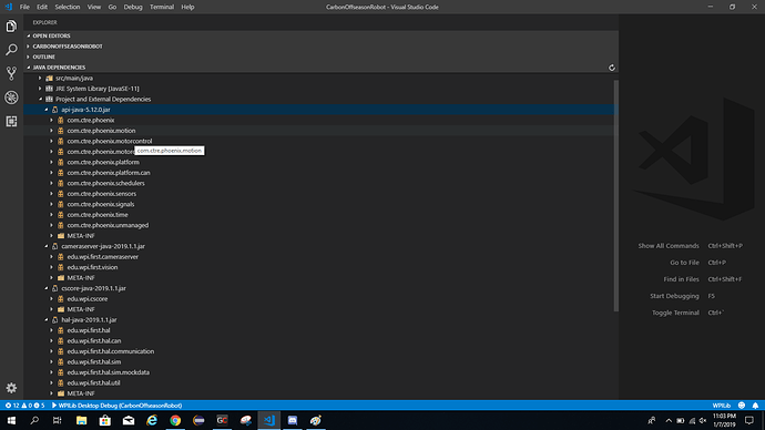

Ok. In the bottom left of vscode, there is a JAVA DEPENDENCIES tree. Expand that entire tree, and post a pic. I need to see what’s in the external libraries part of the tree.
#5
Thanks so much for your help. Here are pictures of the Java Dependencies tree
#6
Ok, I think that’s something wrong with the json file you got from kauai. Where did you get it, did you use their installer? I wonder if somehow you got a beta version.
Can you replace the entire contents of the navx json file with what’s here.
