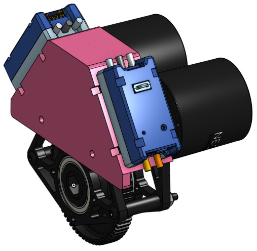

We were actually just looking at this last night… very early design for a 3D printed shield on the Rev 2-motor drivetrain gearbox:
Give you a nice mounting spot for the speed controllers, while helping to protect the gearbox from falling debris (different gearbox, but similar open design - we had a heck of a time when a drilled out pop rivet fell into it…)

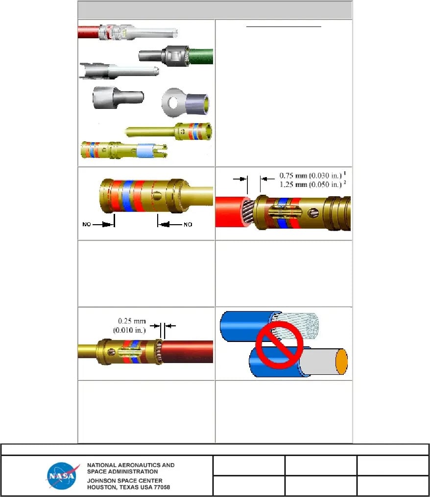

Andersons perform better whether crimped or soldered.
Crimp terminals should not be soldered after crimping. See this from NASA’s crimping workmanship standard.
You can dig into the standard or search CD for more of my posts on the subject for more information.
