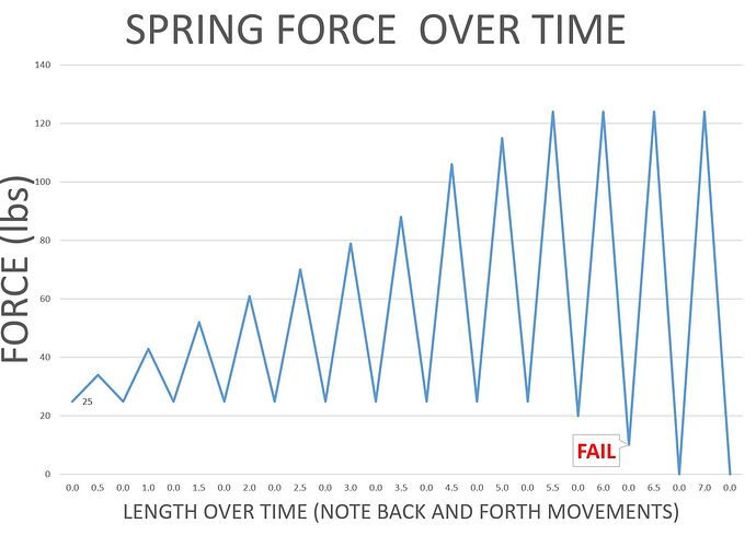

I think that in this case, the fastest way to discover the answer is for someone reading this messaging who also has access to an “Instron” to do a test for me.
Here is the procedure:
  • Take a 9" length of the 9664k68 spring (the length of the peg), bend hooks into each end (snap a picture next to a scale so we can estimate the “active coils” of the spring – not 100% needed but helpful)
  • Install the spring into an Instron.
  • Pull slowly from unloaded to loaded state.
  • Zero the travel when the coils first start to separate (should be ~25lbs)
  • Move to .5". Note force
  • Move back to 0.0" travel. Note force
  • Move to 1.0". Note force
  • Move to 1.5". Note force
  • continue going up by 0.5" increments until the force at the Zero Position has reduced by significant amount (see example data chart below)
A music wire spring should fail to return to the 25lbs* somewhere near 5" of extension. A spring made with steel with a lower yield will fail to return to 25lbs* at after smaller extension.

I am working with a prototype source that can pretty quickly turn around making 1000 of these springs made from Music Wire. But it won’t be done with money you find in the crevices of your couch ($2K). AND if the spring is already made in a way that gives it close to the properties that a Music Wire then what is the point?
HOWEVER, I have pretty good reason to believe that if you do this test, the spring will “fail” (per my test above) at 2-3" rather than 5-6"
IF that is the case, then there is reason to believe that if we make Pegs from springs are made from Music Wire, the Peg performance would go up significantly.
