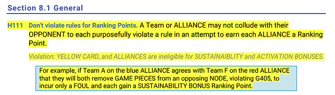

But isn’t it explicitly said by the blue box?
What rule do you think would be violated by the proposal in this thread?
H111 blue box.
H111 only applies if you are violating another rule. Which other rule is being violated by dropping a game piece near your opponents scoring area?
In my interpretation the blue box in H111 is to combat a strategy discussed here: Wait, does G405 means that both alliance can receive a free Bonus if discuss properly?

One, blue boxes do not have the force of rules. They’re intended to clarify rules and provide examples.
Two, there is no specific rule against giving your opponent game pieces, intentionally or accidentally.
You’d have better arguments with OTHER rules. I would suggest G108 or G207–the former isn’t an issue if your bumpers stay on the proper side of the Barrier, and the latter isn’t an issue until someone runs into you, which if you’re coordinating they won’t.
And for H105, H106, and H107… It would be difficult to argue that you’re tanking for someone else’s ranking.
