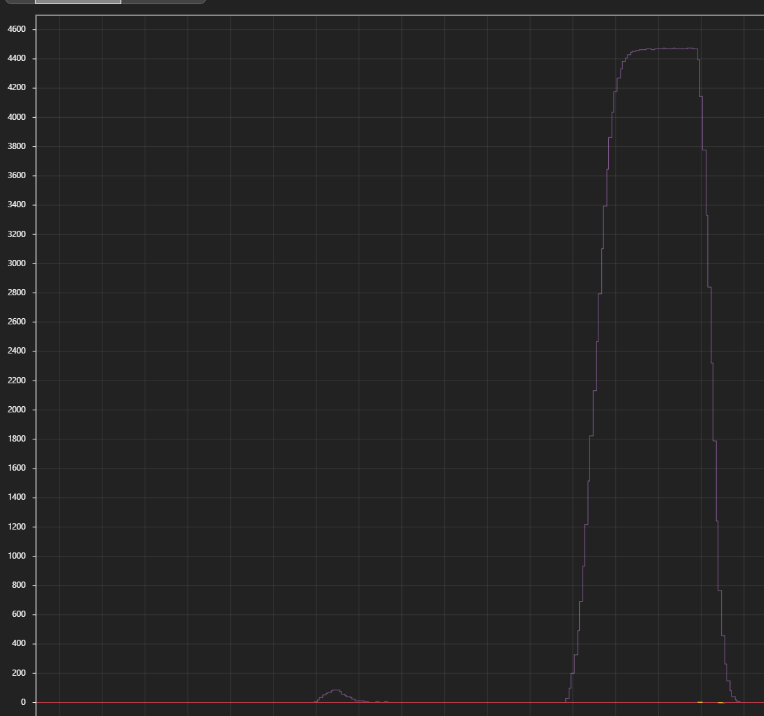

Our team is running 4x Neo 550s on our shooter this year which are all, ideally, independently controlled. We decided to run the velocity PID loop onboard the SparkMax and are experiencing odd behaviour:

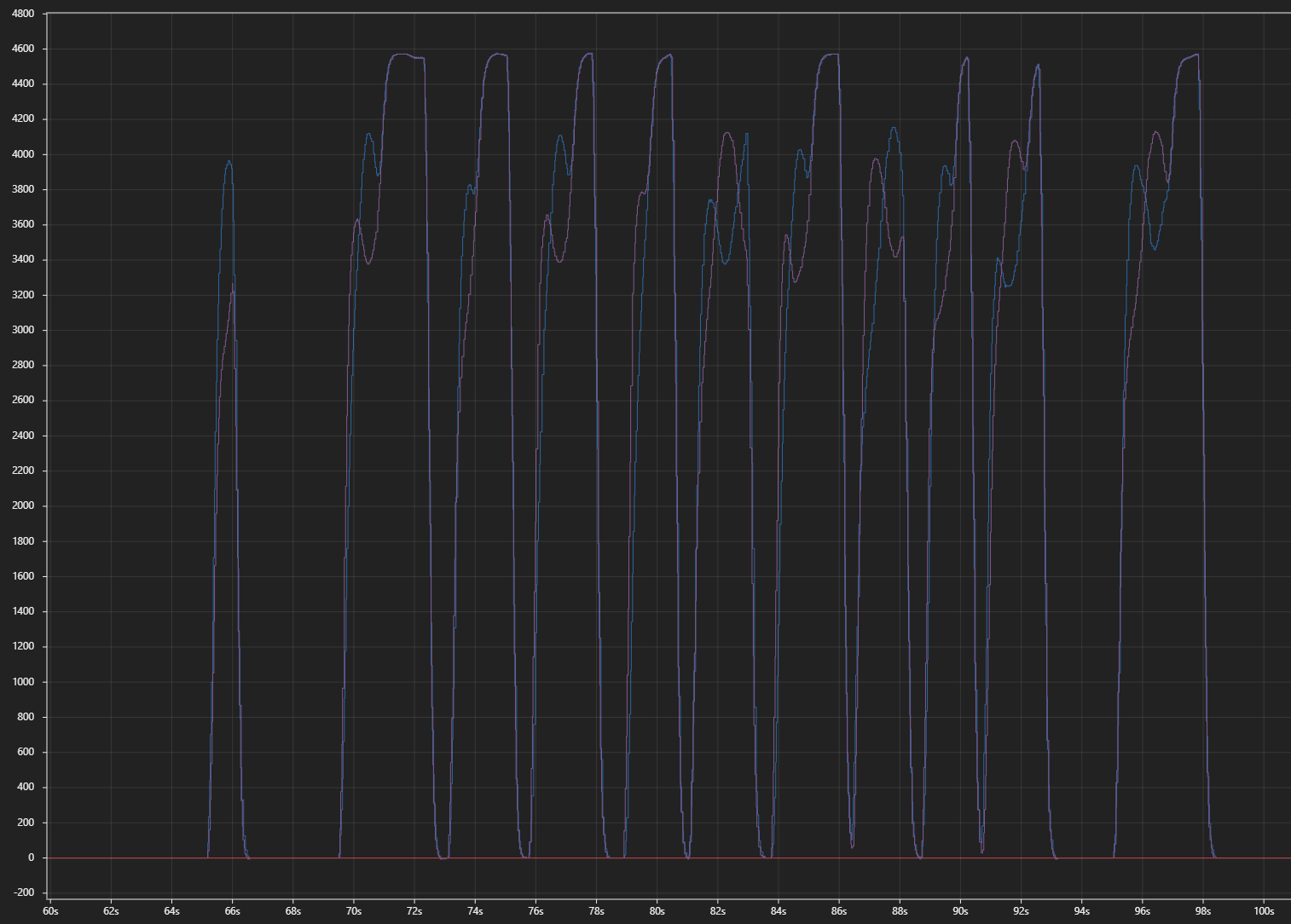

The graph shows the onboard controller for two of our SparkMaxes targeting 4000rpm solely with a feedfoward of 0.0001. As you can see the behaviour is inconsistent from run to run.

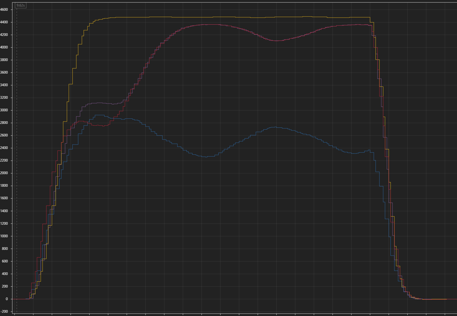

The behaviour becomes more sporadic as more SparkMaxes are ran; however, one SparkMax is always performing as expected. We observed this to be true regardless of which SparkMaxes are ran:
Also, the odd behaviour doesn’t occur when running motors one at a time:

See PSA: Default NEO/SparkMax velocity readings are still bad for flywheels
The default filtering settings on the spark max are bad which results in adding so much latency to the velocity measurements that the system is uncontrollable. The filtering can be adjusted to decrease the latency at the cost of more noise which is at least controllable but still terrible.
Thanks for your reply. I’m not sure this is the problem since the behaviour isn’t constant but only occurs when multiple motors are running. Would the velocity readings have an effect in this situation? I can try to play around with the encoder settings the next time I have access to the robot.

You’re trading off between signal delay and noise. The total signal delay is about half of the filter’s total width (so, a 164ms filter - the default - introduces about 82 ms of delay in the signal).
If the signal delay is not smaller than the system’s time constant (you can find this w/ ReCalc or SysId), then you’ll have problems applying meaningful corrective feedback to your system. The max stable feedback gain shrinks exponentially as your signal delay grows past the system time constant.
