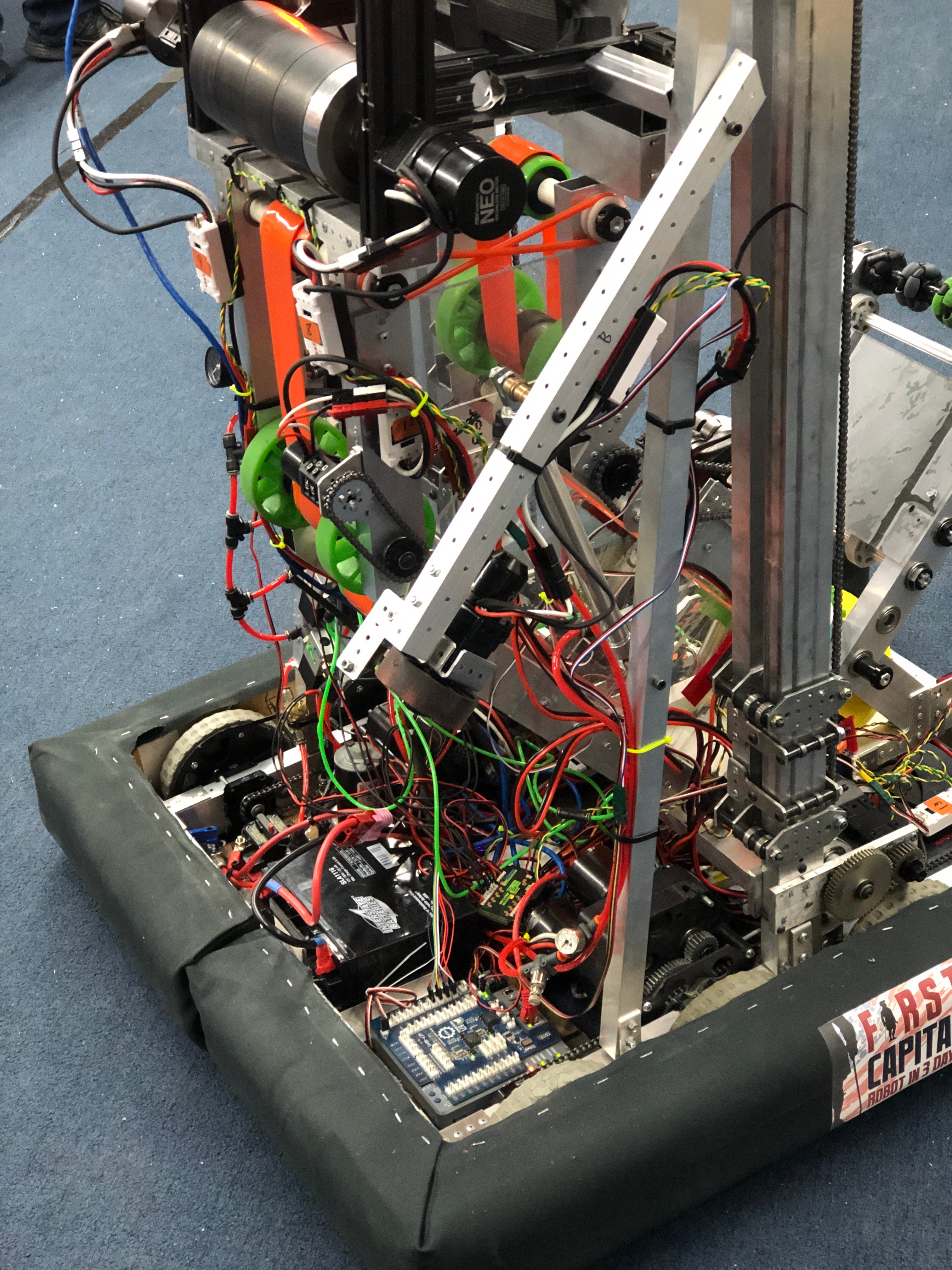

This picture has what Akash is describing on the upper indexing stage
