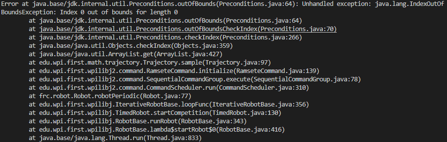

IndexOutOfBounds error when trying to run trajectory
When using a PathWeaver trajectory we are given an IndexOutOfRange error
Any advice?
Sounds like the trajectory has zero points in it? What are you passing in?

How are you loading/generating the trajectory? Like Peter said, the trajectory has 0 points in it so accessing any points will result in that error

What could be happening is that it never loads it and just uses the empty trajectory originally created, I’m not sure how to fix that. I’m not seeing any errors in driver station though.
When the trajectory is put onto a field simulation in robotInit() it appears fine. Could it be an error in how I’m accessing it in RobotContainer?
I found the solution. The robot container, and the auton that used my trajectory was being created before a trajectory was created from my JSON file. To fix, I moved the try statement that got my trajectory from a JSON in robotInit() above the line that creates my robotContainer. Thank you to everyone that helped!
