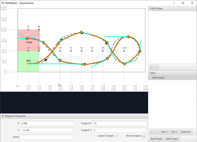

Generate Waypoints using Pathweaver
I used Pathweaver to generate the waypoints. Make sure to set the export unit to Always Meters to match with WPILib’s trajectory classes. The version of Pathweaver in WPILib 2021.1.2 (the current release) doesn’t have field images for the Infinite Recharge at Home challenges. However @jdaming created a pull request to add them: Added the 5 IR @ Home Autonomous Challenges by jasondaming · Pull Request #200 · wpilibsuite/PathWeaver · GitHub Until there’s a new release, you can add them following the instructions here: Adding field images to PathWeaver — FIRST Robotics Competition documentation.
Here’s what my path looked like:
I found that the exported coordinates weren’t right. I had chosen project units of feet to match the lengths in the manual, but to export in meters, to match WPILib Trajectories. If you use meters for both, it should be fine, or this PR should be in the next release.

You want to copy the *.wpilib.json files that are generated when you click “Build Paths” in PathWeaver. You can then load these files in your program and run that trajectory
