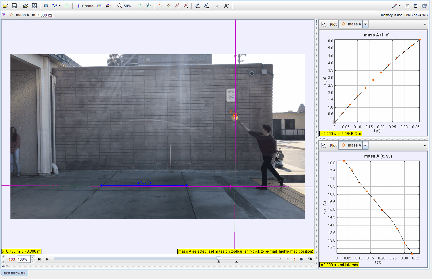

Bit of a shaky cam, but this is some trajectory tracking we did today.
Its a bit fast on the gif, but Vx is dropping over a roughly 6m displacement. Roughly 16-19 m/s^2.
We did some lob throws as well and got much lower drag accelerations, but for those looking to shoot from a fair distance, expect to wrangle with the shooting dynamics.
Click to see rapidly looping GIF
