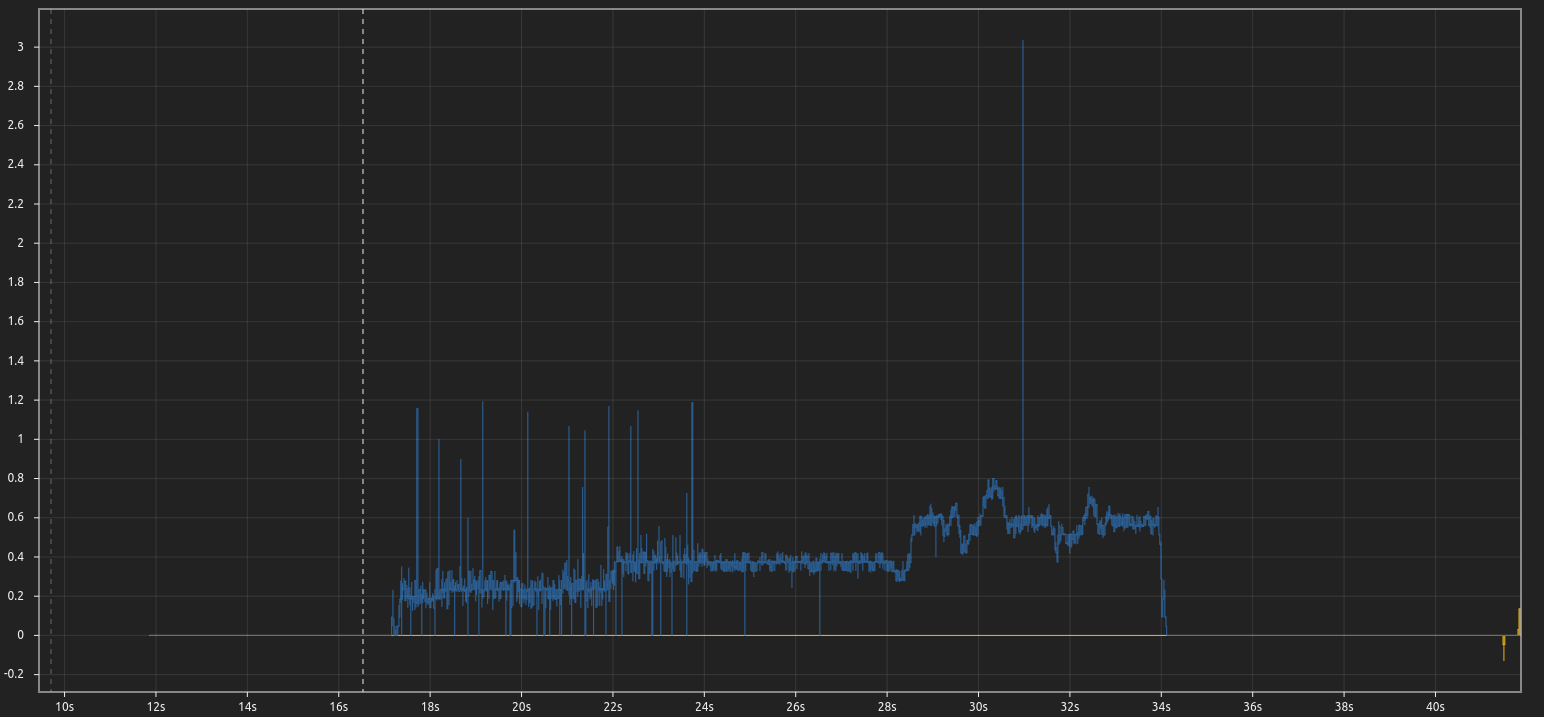

We’ve been really struggling this year with velocity noise on the REV Throughbore encoder. We have one on each side of our drive train (custom WCD), on the same shaft as the center traction wheel (corner omnis), with the quadrature output wired to the DIO on the rio. There’s no noticeable amount of backlash from the wheel to the encoder, and our drive motors are situated by the back wheels, so about 10+ inches away from the encoders. We’ve tried upping the samples averaged in the encoder class, but this doesn’t help as much as hoped.
This is a velocity vs time plot for the wheel spinning free with the axle disconnected on the default of 1 sample per average.
This is another plot with the samples averaged turned up to 60, driven by a drill at different speeds.
Here’s similar data, but this time with the velocity calculated by dividing the change in reported encoder distance by the time measured since the last calculation. These spikes are mostly due to GC or some timing wackiness in Java, but similar spikes show up on occasion when running with low (<10) samples per average and higher speeds.
Note: All these tests were run with the robot disabled and the drive motors disconnected from the controllers, so EMI from motors seems an unlikely culprit.

What is the vertical scale in these plots? How fast is the shaft actually spinning? Velocity measurement on the Rio for quadrature type encoders works by measuring the length of the pulses. The sampling rate is 40 MHz, and the encoder has 2048 cycles per revolution. If we know how fast the shaft is actually spinning we can estimate how much noise is just due to the FPGA sample rate.

Meters per second. The spikes are definitely from java, but I’ve seen similar amplitude spikes using the FPGA reported number when running with <10~ samples per average.

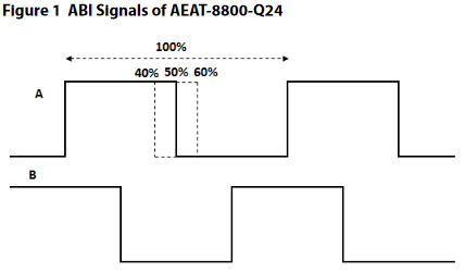

The problem may be a fundamental incompatibility between the sensor used in the throughbore encoder and the way the FPGA measures rate, at least with 4x decoding. The AEAT-8800 sensor datasheet has this concerning statement and figure:
With reference to the output period at A and B. The relative accuracy of the edges to each
other at a CPR setting of 256 is within ± 10% for 5V operation in a typical condition. Therefore, based on a period at A or B, the edge occurs in a window between 40% and 60% as shown in
the following figure.
I read this as meaning the pulse length may not be well controlled and could vary as much as +/-10%. This is not at all how optical encoders behave, and would almost certainly explain the noise you’re seeing. Definitely try 1x decoding, as doing so would change it to measuring rising-to-rising and might mitigate this particular oddity as well as decrease overall measurement noise.

Well, so much for that potential workaround… If the edge uncertainty applies more broadly, though, that could certainly explain the issue. We’d have to do some scope measurements to verify.
