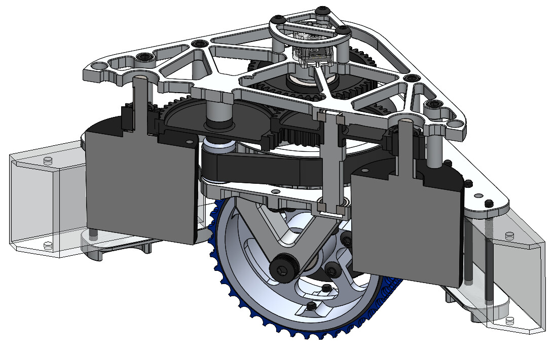

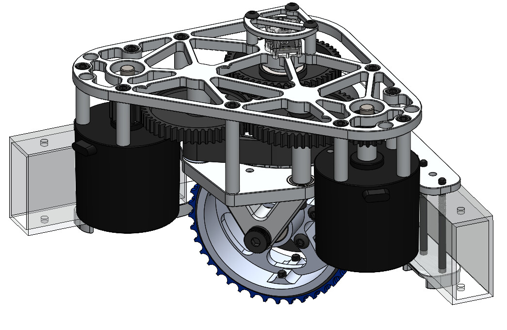

All of the hardware to mount the pinons to the NEOs is included in the small gears bag. The steering motor uses the short spacer, then the gear and machine key, and then the retaining ring. The drive motor uses the long spacer, then the gear and machine key, and then the retaining ring.
3 of the mounting screws and spacers are used to mount each of the NEO motors to the top plate.
Below are some screenshots of the CAD for reference:
