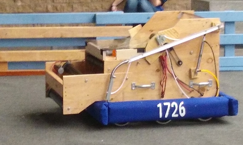

Also, a warning about polycarb intakes - don’t use polycarb tubing. You’ll lose the rigidity of aluminum tubing and end up with something that cracks easily when hit. Stick to sheet so your mechanism will actually comply.
2x4 ftw
We have to drive around with another robot and see how it does. I expect the intake on ours will pop up over the other robot’s bumpers, and cause foul inducing damage to the other robot inside it’s frame perimeter.
Love the organic cellulose composite intake :wink:
