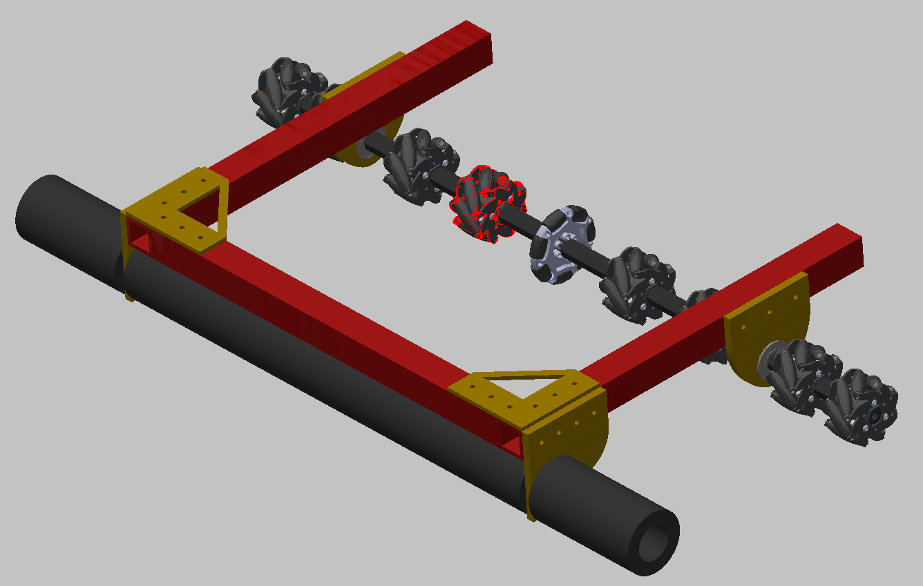

I suppose it’s disingenuous to create this thread without sharing something of my own.
Here is what our most recent iteration of our intake looks like in CAD. We are fabricating it (without the paint obviously) out of plastic tubing tonight.
Our main concern is how it will handle multiple balls at once. If two balls were to enter the intake from opposite sides at the same distance from the center, the thought is that they will collide at the center and jam.
