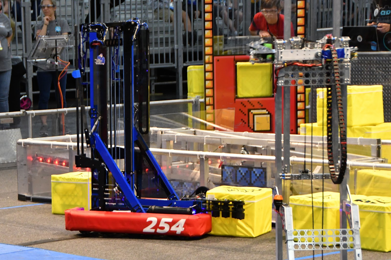

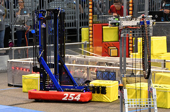

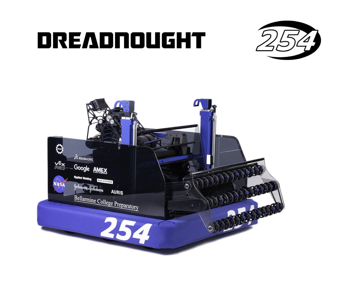

Rollers are wheels, rod, or some other rotating part that move an object that is in contact with it. A top roller would be a roller that moves an object by touching it’s top. Here are a few pictures:

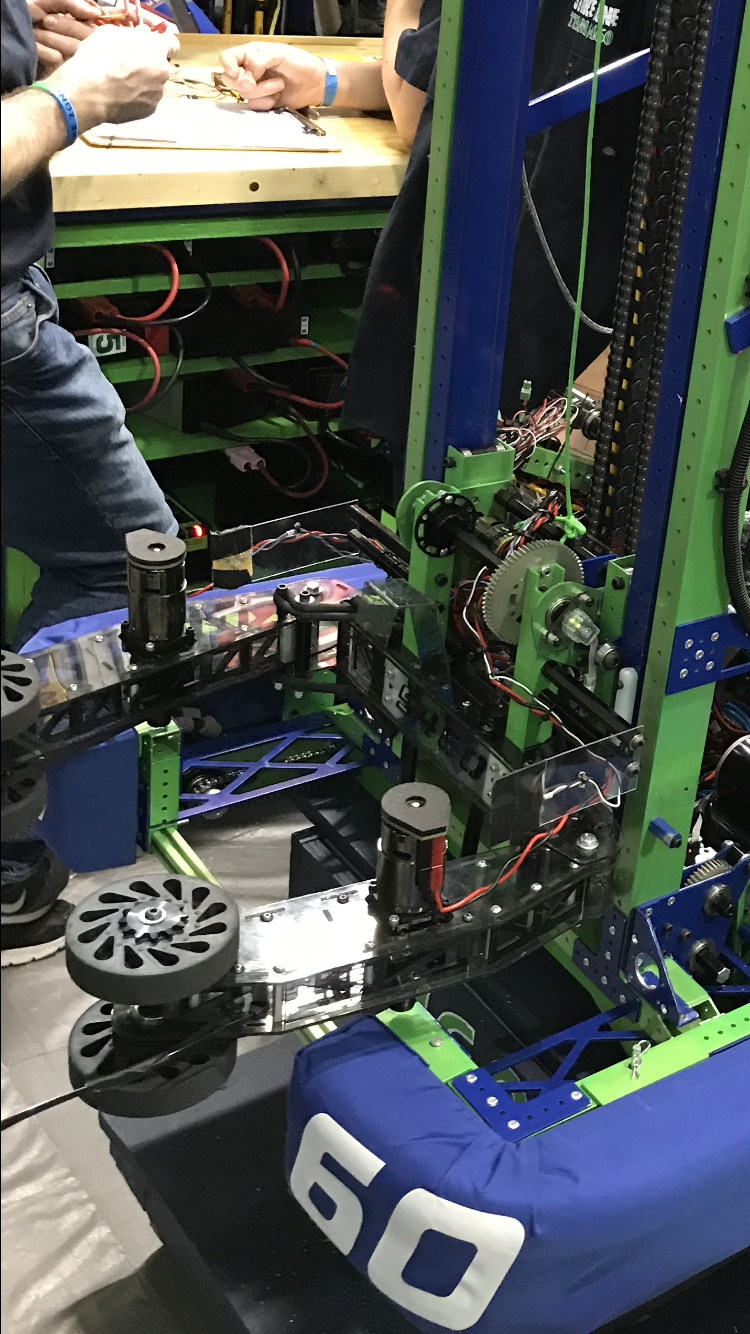

Side rollers move objects by grabbing their sides. Here are some more examples:
Here are a couple of examples of combining top and side rollers:

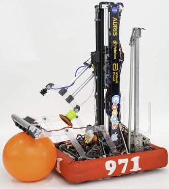

I’m not quite sure what you mean by scoop, and I can’t think of anything I’ve seen in FRC for scoops. Maybe some team tried it in 1992? (If someone else knows of a scoop mechanism in FRC, please share!) But a scoop would intake objects by getting underneath of the object and lifting it off the ground. Such as a front end loader:
EDIT: I think the closest thing I could find to a scoop is this robot in the 2017 Game Animation
Video
Some 2017 gear intakes had a top roller with a thin sheet underneath, combining a scoop with a roller, like 5803. A couple teams in 2019 had passive scoop ground hatch intakes, like 1410 and 144 (couldn’t find a good example of this). Also, 1986 in 2013 used a passive scoop intake, and I’m sure others did too.
