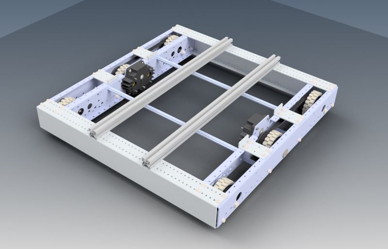

One of my favourite upgrades to a kit-bot chassis is to mount two parallel aluminum extrusions to act as a base to whatever mechanism they plan to mount. The rails can be longitudinal or transverse, but I find the extrusion to be a flexible means of attaching something to the chassis.
Your other option would be Vex VersaFrame, which would be well suited to a team with equipment limitations.
