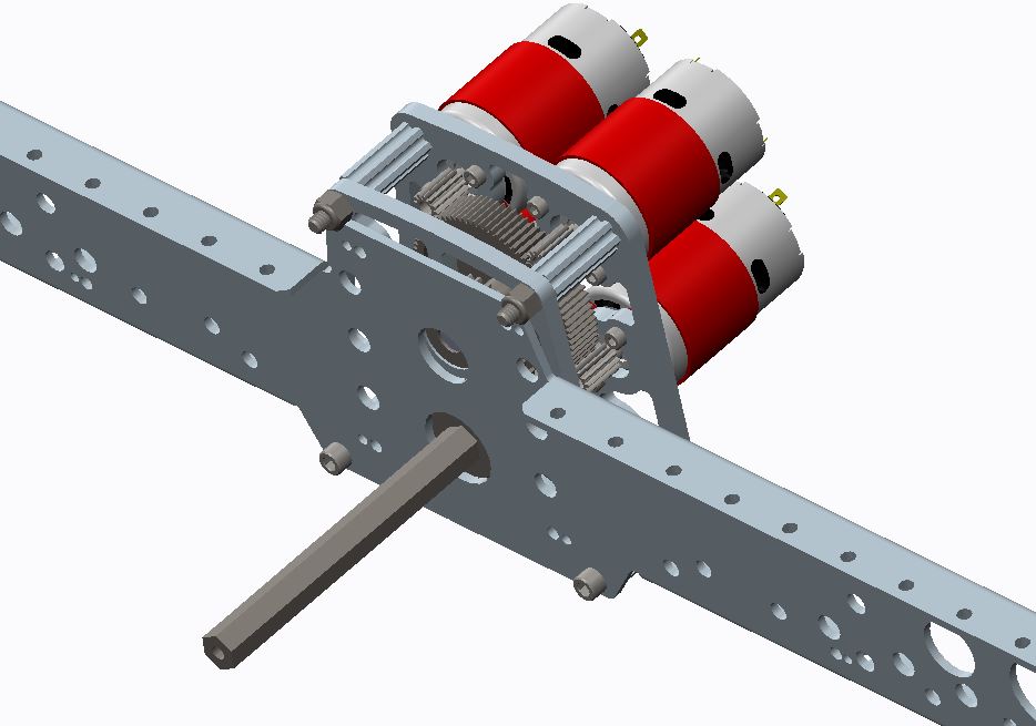

Back to the OP topic: the thumbnail below shows my latest favorite KoP chassis upgrade.
You discussed attaching versaframe via small tubes mounted to the top of the chassis, with gussets off those. Another option we have used is to have vertical pieces of versaframe bolted directly to the inner rails of the AM14U3. You can see this on the back of our robot from this year, there are parallel 2x1 versaframe tubes that bolt to the inside of AM14U3 and rest on the flange of the inner rail on each side. We’ve done this the last two years and it has made mounting a super structure really easy for us. The bonus is that you can typically remove the entire upper structure by removing 6 - 10 bolts for the handful of places those tubes attach to the KOP chassis.
My number one improvement to the KOP chassis each year is to modify the wheel size/type and gear ratio. The wheels and gears included in the KOP work, but are not very well optimized. We’ve either gone larger (2016, 2018) or smaller (2017) most years and changed the gearing to achieve a faster speed. We still use the Toughboxes just swap out the gear sets with others from AM. The wheel changes can get a little time consuming, if you can stick with the HiGrips then it is just a case of getting different belts but if you have to go to 8" wheels the HiGrips are out. That forces you to change spacers for the Plaction or VEX Traction wheels or go all out with a wider wheel channel for the pneumatic tires, and we had to notch the end plates on the KOP chassis to fit the wheels some years (take a look at the end wheels on the picture I linked to). It’s not difficult but for teams with very limited capabilities it can be issues they overlook until they run into them. The chassis notching delayed us getting the chassis put together by a week since we don’t meet often.
3946 did something quite similar this year on our Bayou bot, using 3x1x1/8" channel (super easy to mount TB micros to and run chain inside). We had a heck of a time getting everything square or even consistent from side to side and robot to robot. It also interfered with the wheel mounts on those corners, and (in our design) was NOT easy to remove with wheels on one side and control systems on the other. Would not likely do again for a light-duty elevator; would have redesigned the climber to only need to be so sturdy in tension.
