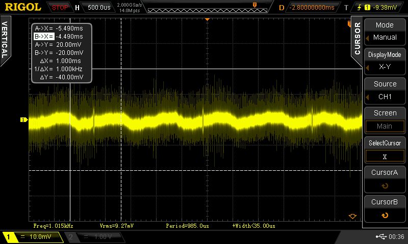

Not just different current levels. They are using different technologies.
Beak uses DC ΔV/ΔI
EM3610 uses 1000Hz AC

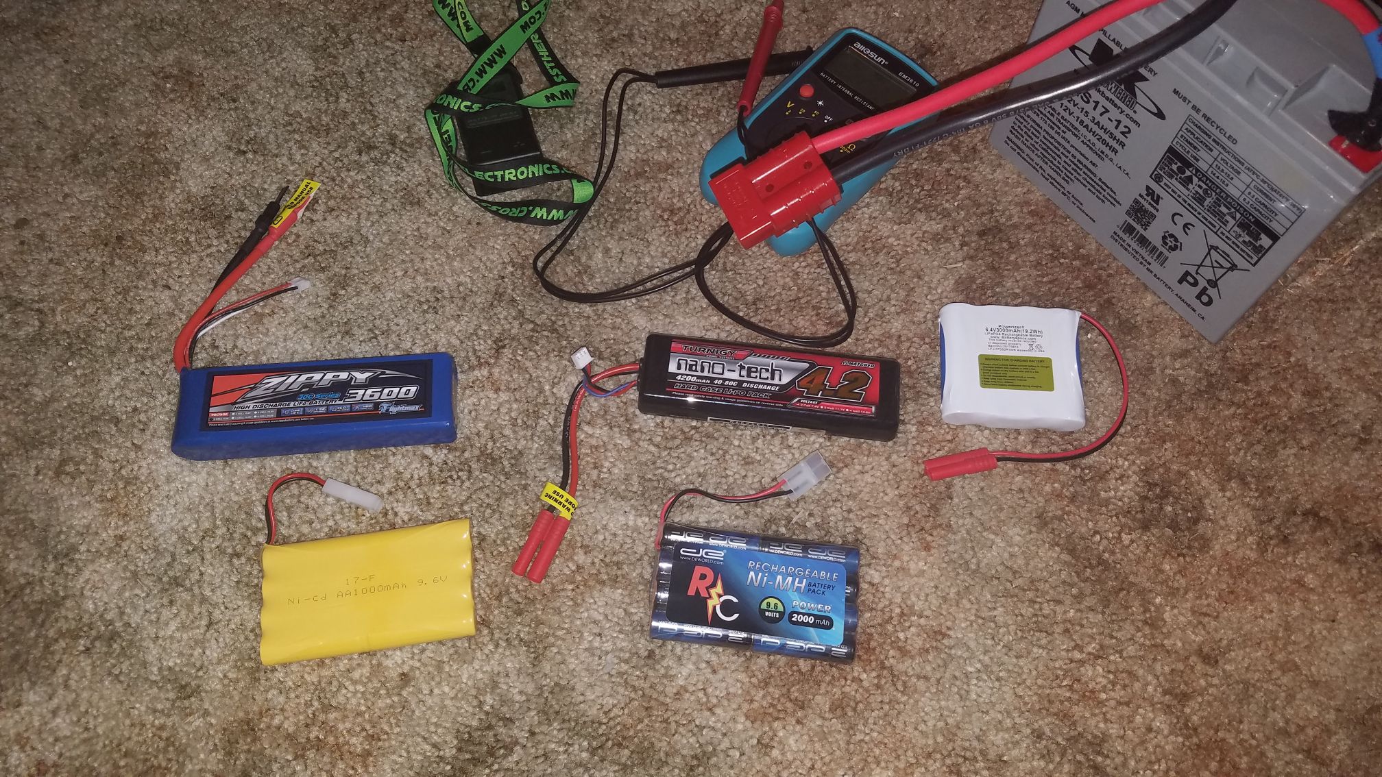

I don’t have any more time to play with this tonight. I’ll try to connect my oscilloscope across a passive resistor under test with the EM3610 and see if I can determine what it’s doing.
I don’t know if merely placing a fixed resistance across the battery is a good test when one considers that the ESC are chopping the DC to power the motors who’s windings are clearly not passive resistive loads. However the measurements produced don’t deviate so much that I am as confused as I was when I was trying to reconcile the internal resistance measurements from the Turnigy Reaktor 250 and it was doing stuff like this:

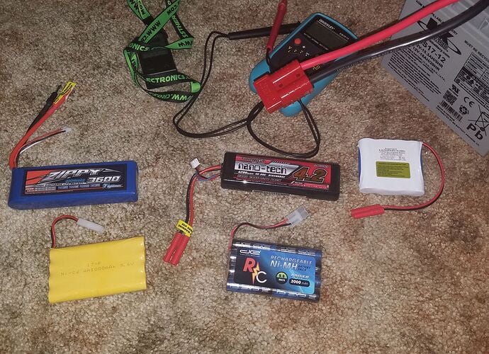

Battery            Voltage     Reaktor 250     EM3610      Approx Error % (EM3610/Reaktor250)
FRC lead acid      13.8        92mOhm          12.7mOhm    63% (accounted for readings of wires for 45 mOhms)
LiFePo4 custom     6.4         139mOhm         75.7mOhm    53%
LiFePo4 Zippy RC   6.6         56mOhm          29.5mOhm    53%
DeWorld NiMH       9.6         405mOhm         251mOhm     63%
NiCd pack          9.6         410mOhm         220mOhm     53%
Reaktor 250 charger readings are 1.8x - 1.9x higher or 1.6x - 1.7x higher than the EM3610 readings.
The increased error tracks circuits with very different wire gauge sizes in the path to the battery assembly.
Basically I’d take these readings over the 2 wire readings from the Turnigy Reaktor 250 charger across the board.
The Reaktor only behaved itself with the balance charging connectors in use.

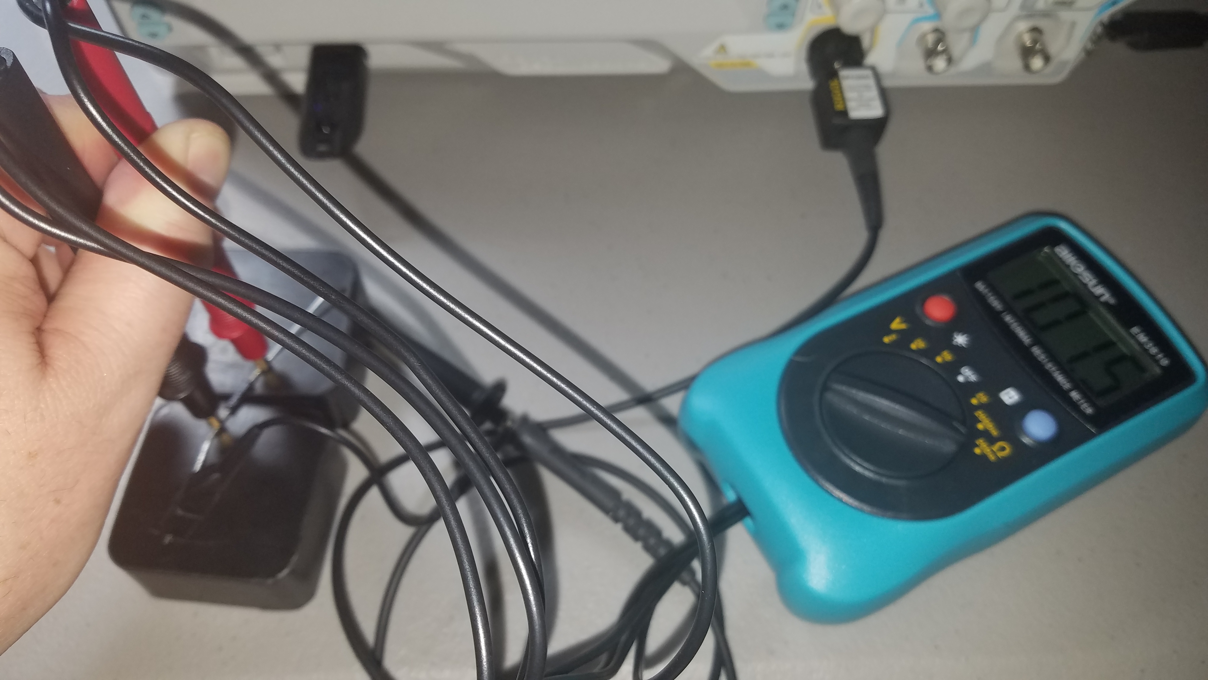

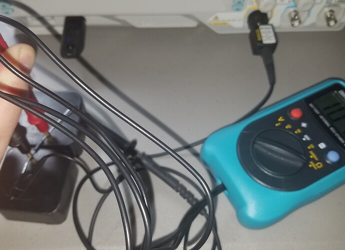

It was tough to measure the output voltages from the EM3610 meter on the 100 mOhm resistor A from the last post.
Attached is the best I could do with my Rigol DS2072A. Notice the cursors read 1kHz between the pulses but they are very faint with a ton of background noise at such a high sensitivity. I confirmed that this signal disappears when the meter is removed though the noise remains. Also notice this was done with a Rigol 10X probe and on Channel 1 and it’s been adjusted to 10X so no need to divide or multiply. The voltage scale is true. I confirmed it with a battery just to be sure. I was not able to see the impact of the meter at all with the FRC battery attached. Maybe with a AAA battery but needless to say I don’t think this signal is much an issue for the battery to deal with voltage wise. In the picture the reading for that resistor can be seen on the EM3610 display.
I’ve also attached a picture of all the batteries I’ve mentioned in previous post, including a LiPo battery I haven’t tested with the EM3610 because it’s internal resistance is extremely low. It reads: 7.0 mOhms on the EM3610 meter at the power connector end. That same battery reads as 2 mOhms per pack x 2 from the balance connector on the Turnigy Reactor 250 internal resistance measurements. That extra 3 mOhms seems fairly reasonable.
When read on the same power connector I used for the EM3610 measurement I got 3 repeated 37 mOhm measurements on that Turnigy Reactor 250 charger internal resistance measurement. Which is 5.3 times too high following the same pattern I have been seeing with an even greater severity.
