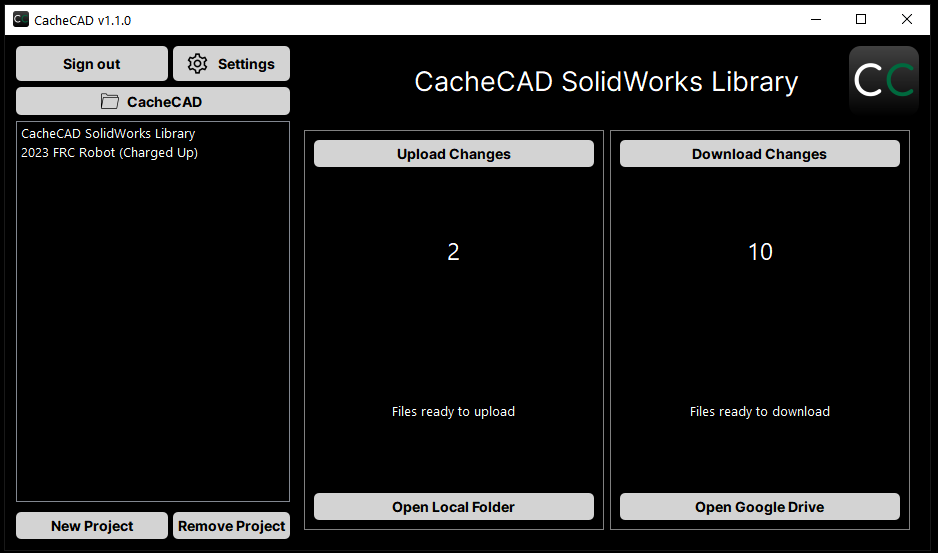

Introducing CacheCAD
I’m very excited to introduce CacheCAD to the FRC community.
CacheCAD is a file management interface for Google Drive developed with Team 8096, Cache Money. Unlike the Google Drive app, CacheCAD lets you selectively sync your files with a simple interface. It aims to be a true GrabCAD replacement.
Google Drive is ideal because all user setup, permissions, and sharing settings are handled through the Google web interface which many teams are familiar with and already using. Because all data is hosted on Google Drive, you don’t need to worry about CacheCAD having accessing to any of your data.
CacheCAD is free for non-commercial use and available for download, but donations to support CacheCAD’s continued development are welcome and appreciated.
We’ve done some pretty extensive testing on CacheCAD, and we’re at over 10k successful file transfers in beta testing. There’s definitely still a few bugs and crashes here and there, so feel free to reach out for support, and please keep a backup of your files (no one has lost data that I am aware of, but better safe than sorry).
If you run into any unexpected bugs or crashes please reach out via DM on CD or send an email to [email protected] (students please include a mod or mentor in message / emails)

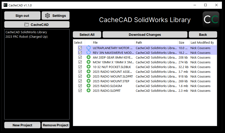

Google drive does this. There is a setting in CacheCAD where you can choose between keeping previous versions for 30 days or forever. This is just taken directly from the options Google Drive has.
This setting is by default turned off (meaning it will only keep previous versions for 30 days) in CacheCAD. We (8096) haven’t felt the need to change this as it is very rare that after 30 days we would need to find an older version of a CAD file, and setting it to forever will start to take up a lot of Google drive space.
I also occasionally make a copy of my local CacheCAD folder just as an extra backup to Google drive.
