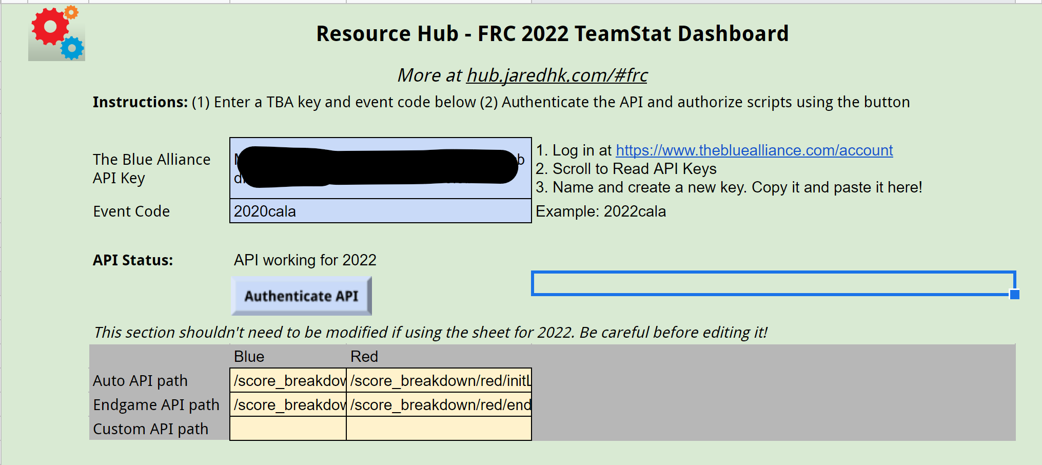

Configure your event
Simply grab an API key from The Blue Alliance (takes just a minute), enter your event code, and go. The config page also supports custom API data you may want to collect.

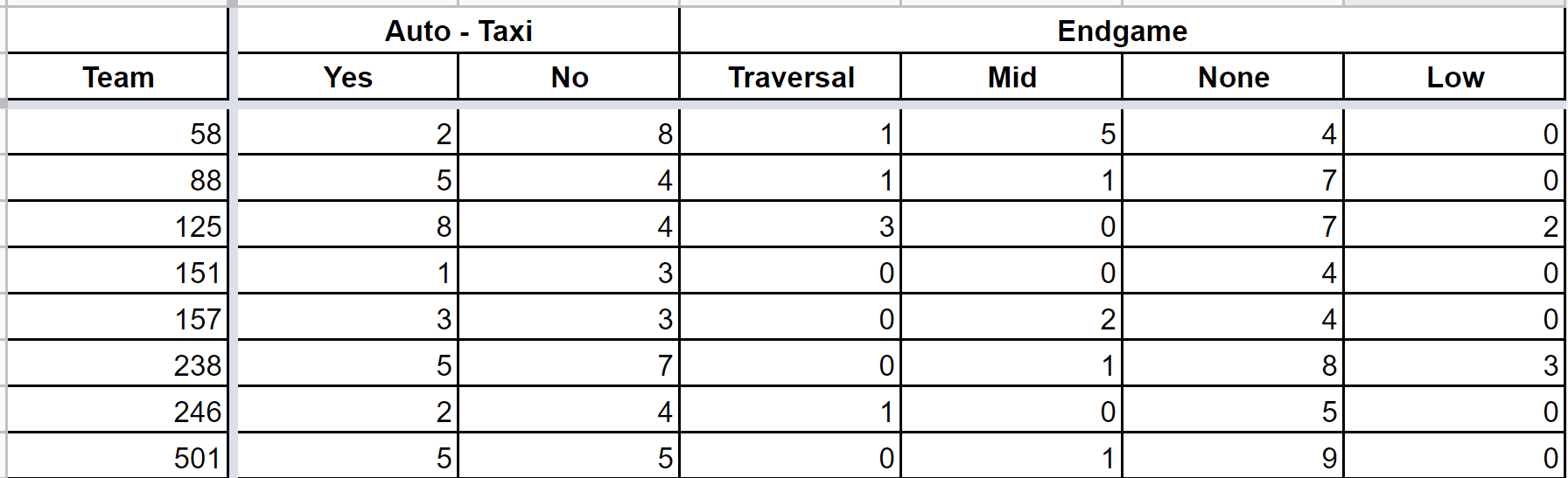

EDIT: Made some data improvements which impact the stats below. More importantly, you should make a fresh copy of the sheet. There were some mismatched rows in the old sheet.
Seems to be working with Week0 data, though when I have a bit more time I’ll go in and do one more quality check. Please let me know if you have any issues!

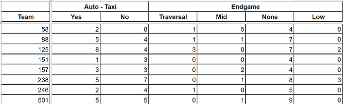

Some interesting week 0 data:

Raw data
Auto - Taxi Endgame
Team Yes No Mid None Traversal Low
58 1 10 11 0 0 0
88 3 5 1 7 0 0
125 8 2 0 2 6 2
151 0 4 2 2 0 0
157 3 3 0 6 0 0
238 5 5 0 8 0 2
246 3 3 0 6 0 0
501 8 3 0 11 0 0
509 0 7 0 0 7 0
811 1 5 0 6 0 0
1073 3 5 0 8 0 0
1153 2 8 3 7 0 0
1721 1 6 0 7 0 0
2342 2 2 0 4 0 0
2370 1 5 2 4 0 0
2713 4 6 4 6 0 0
3467 2 5 6 0 0 1
4041 3 3 0 6 0 0
4909 2 4 0 6 0 0
5459 7 3 0 8 0 2
5687 2 8 1 9 0 0
5813 9 2 0 11 0 0
6153 0 4 0 4 0 0
8724 2 6 4 4 0 0
8897 0 2 0 2 0 0
8898 0 2 0 2 0 0
8899 0 2 0 2 0 0
Stats
Auto Taxi: 37.5% (72/192)
No Climb: 66.67% (138/192)
Low Climb: 3.65% (7/192)
Mid Climb: 17.7% (34/192)
High Climb: 0% (0/192)
Traversal Climb: 6.77% (13/192)

Hey @jaredhk,
I had gotten a copy of your sheet set up and was working great pulling in week 0 data as a test. This morning I went to pull some data for a week 1 event and the API status says it’s not working. I tried generating new keys, punching in different event codes, nothing. I made a second copy of your sheet and that worked immediately with the same keys and event code. Any ideas? Is there a way to re-authenticate the “TeamStat Dashboard” or whatever it was that I had to give permissions to? The only changes I made to the configure tab was adding a custom API path.
Thanks!
One thing I’ve found works when the script hits a snag is to change the event code to another valid code, and then back to the one you want.
If that doesn’t work, feel free to DM me so I can take a closer look at your copy.

I was trying to test this out today with real match data, and when I change the event key, none of the data is populated, just saying loading continuously. Has anyone else had this issue? any fix that you found?
I have tried copying the sheet again, emptying the event code and reentering, trying other keys, nothing seems to work.
Is the script authorized and returning a good message on the setup tab?
Unfortunately it seems that Google Script is having a pervasive problem inconsistency failing to resolve requests for data. I’ve observed this on a number of projects, unrelated to this. This seems to be a new problem that I don’t yet have a good solution for.
I’d try with another Google account and see if that helps. I’ll try to dig into this if it continues after the weekend.
Important Update
You may have noticed that traversal climbs were not counting properly on certain versions of the sheet, depending on when you made a copy. Please make a new copy as this has been fixed.
