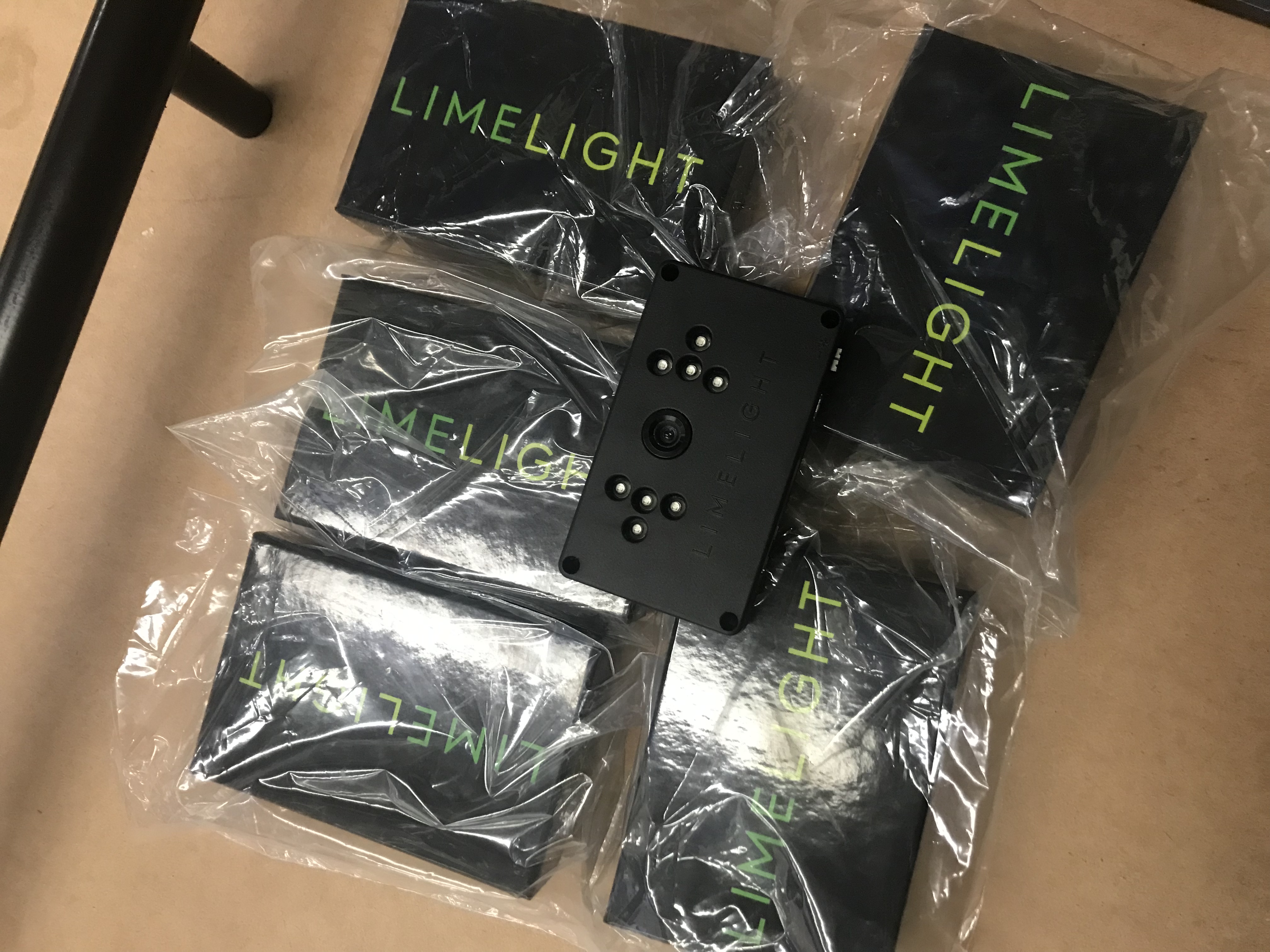

#48
1678 Teaser :wink: :fire: :fire: :fire:
#49
1st 36 Neo/SMs, and now this! Dude, you’re killing me!
#50
How many do you need
#51
That just excessive.
#52
Front and back, three robots…
#53
WoW
