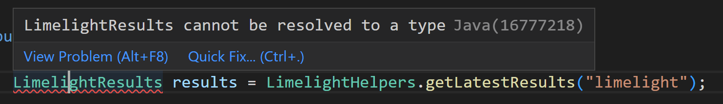

Cool idea but not ready for primetime, at least on the Java side.
The biggest problem is that the JSON features can’t be used outside of frc.robot package because all of the types are package private. In practice, this means I can’t use any of the data in a command or subsystem.
I agree with @mdurrani834, methods shouldn’t return arrays of undocumented numbers, they should return named types. True/False values should be boolean (just add @JsonFormat(shape = Shape.NUMBER)) and WPILib classes should be used for WPI poses. Jackson custom deserializers can make this work.

I might be misunderstanding how use this class but it looks like the LimelightResults that you highlighted is the only one that @Brandon_Hjelstrom forgot to make public and must be fixed to be of use (preferably by a new version today and not by my students having to patch their copy).
