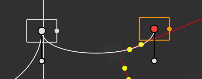

If l draw a path like this , since the heading is the same , so my swerve will only move from the left to the right. However , why is the line between them curving . That’s why?
The holonomic angle only controls the rotation of the robot, not the shape of the path it drives. The control points, which are the small white dots connected to the waypoints with black lines, control the shape. If you drag those around you can change the shape of the curve without moving the waypoint.
