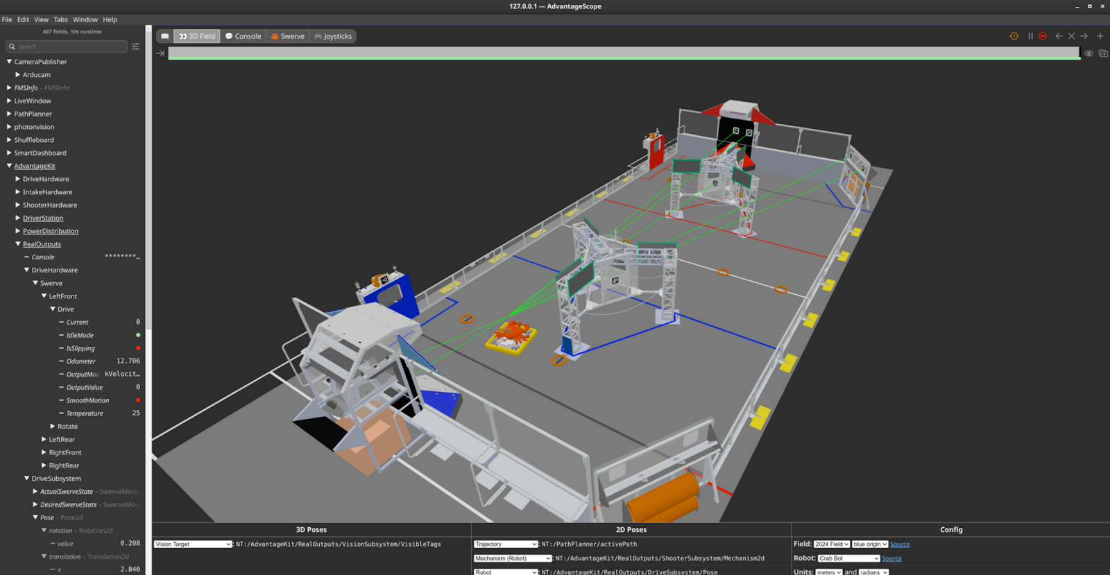

This year, our team has also been pouring a lot of effort into our vision systems, which make extensive use of PhotonVision. In terms of PurpleLib, we have created an AprilTag Camera class that wraps much of the PhotonLib boilerplate for pose estimation. It also filters out invalid poses to provide stable, accurate vision localization data to the pose estimator. Moreover, simulation support for AdvantageScope is built in!
Vision Simulation
We’ve also been experimenting with a custom machine learning pipeline on our own fork of PhotonVision, which communicates with a PyTorch script via gRPC. Our goal is to enable us (and other teams) to leverage a custom mini-PC coprocessor for game piece detection, rather than relying on the built-in machine learning pipeline that depends on the RKNN unit exclusive to the Rockchip SoC (used on the Orange Pi).

High Frequency Odometry
Another exciting feature we’ve implemented is high-frequency pose estimation. This estimation is performed on a thread that updates once every 10 milliseconds (i.e. 100 Hz), while logging still occurs at 50Hz on the main thread, as calls to AdvantageKit “processInputs” are not thread safe.
