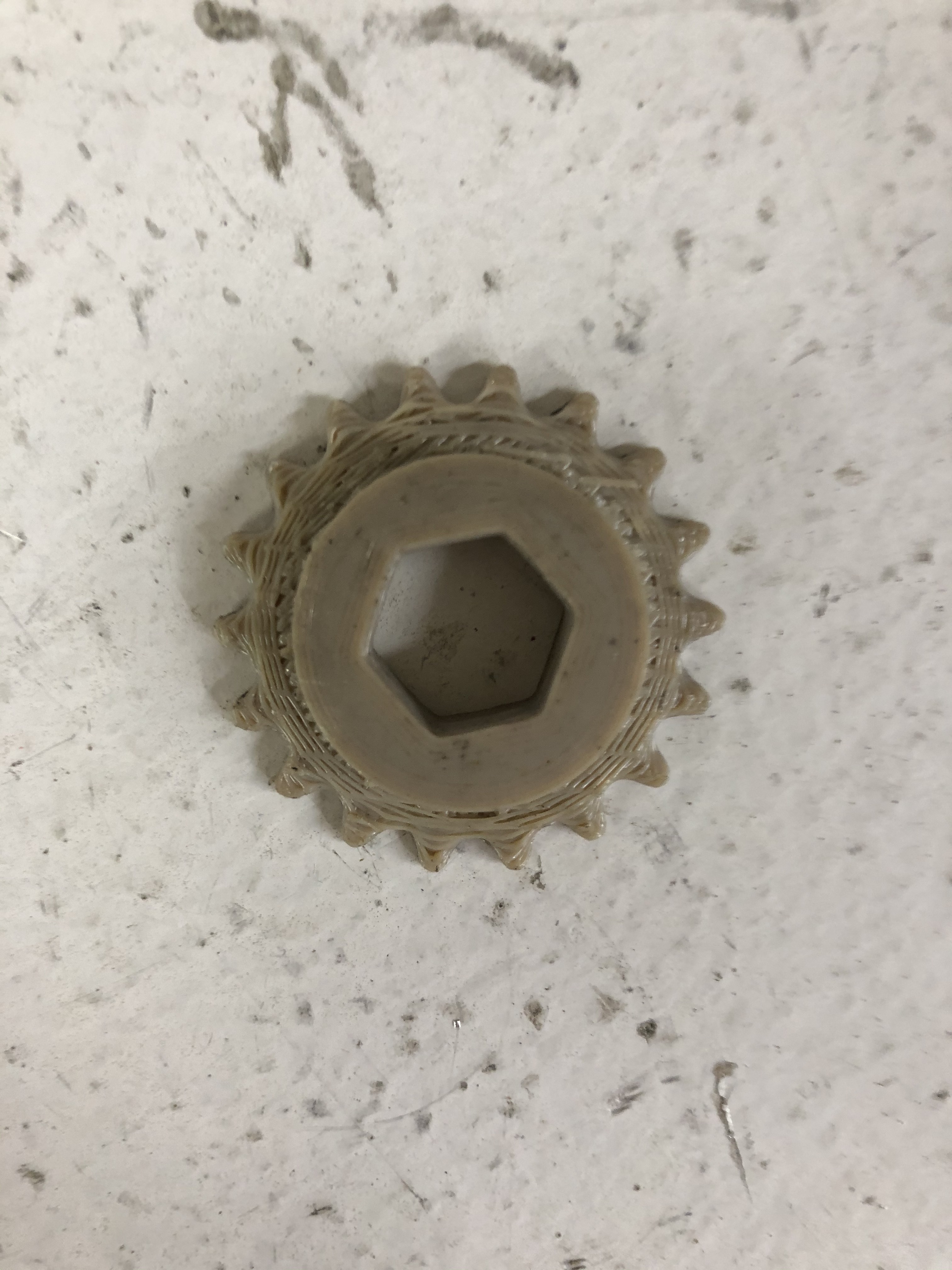

Question for anyone, not just OP: Has anyone ever run MarkForged printed sprockets in a reasonably high-torque application? Is this a thing?
I’ve only ever seen them used as idler pulleys.
@Karson ran some in Ultem on a drivetrain before I think
Do we know what direction the print layers were running on those?
The sprocket was out of PEEK but we never used it because it was too big and didn’t mesh with the chain correctly.
