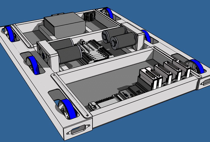

Introducing the BPD: Bullet Proof Drive
This season taught me something new: While thinking outside the box is good, reaching beyond one’s own box of ability is a very poor choice. This season also taught me another good lesson: The ability to design a crab drive does not give one the ability to machine it to acceptable tolerances.
That being said, here goes: Introducing the Bullet Proof Drive!
Here are the concerns that go into this design:
  1. Little to no CNC work needed. All you need to build this is a manual mill. Don’t even need a DRO, if you’re good enough!
  2. Scalability. A team with advanced CNC ability can cut the weight down significantly, and up the features, while a team with only manual mills can make it function quite well.
  3. Weight. 40 pounds without a battery for a bulletproof modular chassis.
  4. Modularity. With either 4 bolts, or 8 1/4" rivets, one can remove and entire side of the chassis. Machine yourself a spare chassis side, and repairs can be done while the robot is on the field.
  5. Cost of Materials. The chassis is designed to allow AndyMark components to be put in at almost any stage, from wheels to gearboxes to sprockets.
  6. Durability. This is the fourth evolution of this chassis. All the weak points have been designed out, while still keeping weight and size down.
  7. Balance. The Chassis itself is perfectly balanced, which allows for one to shift components around as needed.
  8. Ease of maintenance. Tensioning a wheel is as simple as turning two nut drivers. Once you get the feel for the system, this can be done insanely rapidly should the need arrive.
This drive first reared its head in 2006, back when I was on 114. We had sliding pillow blocks inside chassis members, and that let us tension fairly easy. The next season we added in the bolt-pulled tensioning system, and smaller wheels. In 2008, we added the Unibody Extrusion to the module. This significantly cut down on weight, while keeping the number of parts to be machined fairly low.
If the game allows, I have a feeling 1595 may be returning to the BPD next season, unless Mecanums are called for. Questions and comments on the system are more than welcome, and I’m very willing to give out the CAD for the chassis to any who want it. Just email me and I’ll add you to the list of people to send it out. You can email me at iron spork AT gmail DO com.

Speeds for the included gearbox (which requires a CNC) are 9ish fps. Outside of the chassis is 36x26.

Working under the assumption that those are AM Supershifters, how are the encoder mounts affected by this design?

Thanks! Those exact gearboxes aren’t Supershifters. The Supershifter works for this, but needs a little bit of tweaking on the mounting plate (By tweaking I mean drilling two holes and countersinking two more). Also, encoders are mounted elsewhere in the drive. There’s a handy-dandy mechanism that will measure left side and right side speed directly off the ground, rather than off the wheel speed. If one really wants to add encoders to the drive system as well, it WOULD open up some interesting traction control ideas… I’ll have to look into this.

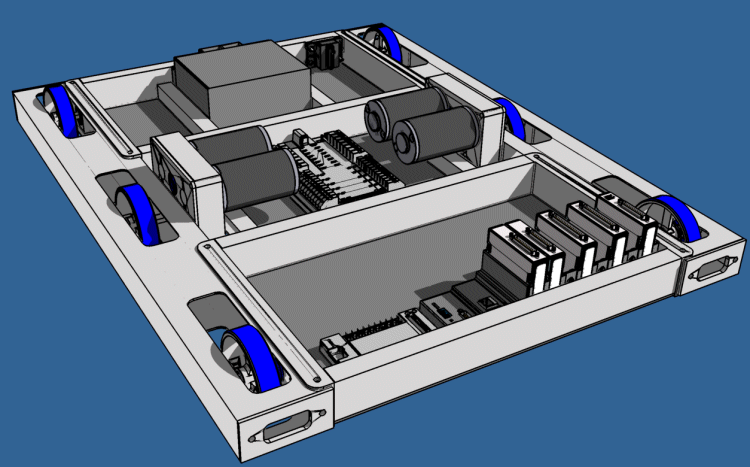

For some reason, I’m not seeing any pictures on this thread (am I supposed too?) :confused:
Could you email me a picture Craig?

I can’t exactly tell, is this showing off a possible design for your team, or one that you want to encourage lower resourced teams to make?

It’s both a possible design for our team, and something that other teams could make. It’s really not too bad machine-wise, all you need is a manual mill and some AM parts.
