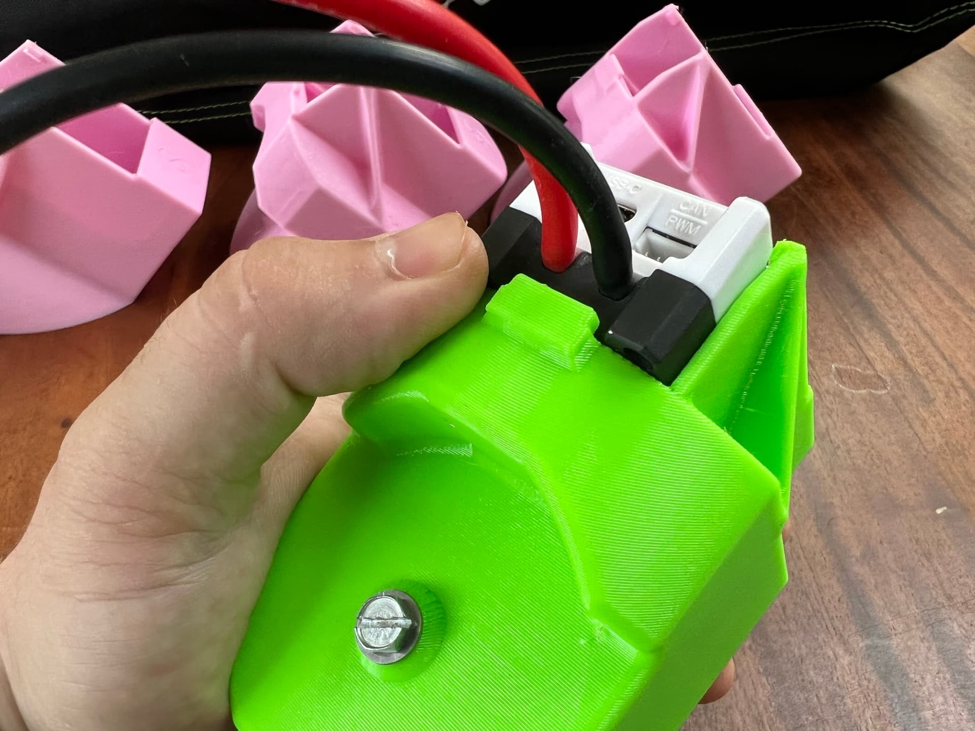

We’re proud to finally release the Hurrilink Sidecar, a self contained Neo 1.1/Sparkmax adapter that shields the high voltage and encoder wires from damage or pullout. It includes the same click-lock double controller retention requiring no hardware as the Base Hurrilink, and prints completely support free.

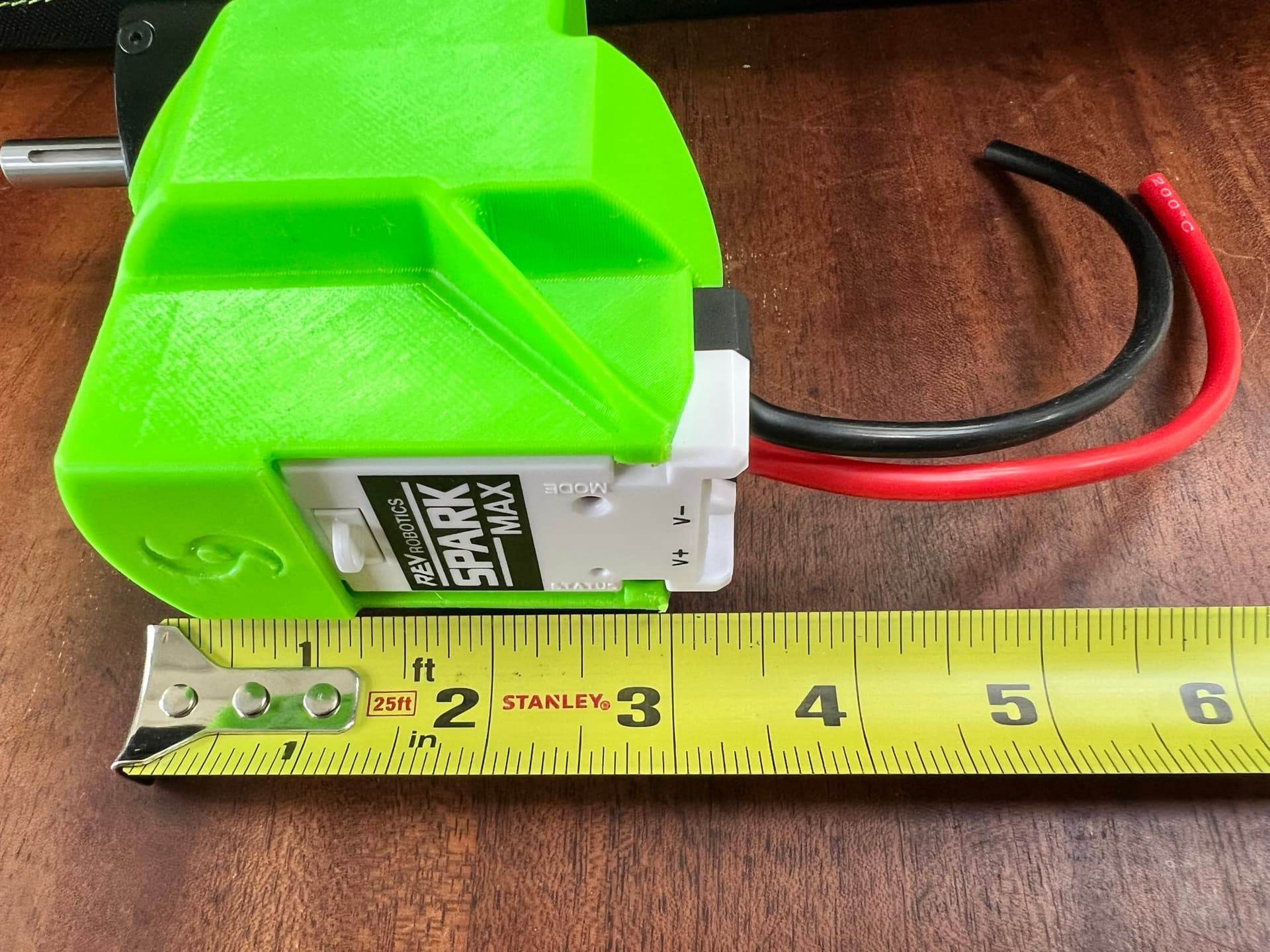

The sidecar arrangement of motor and controller results in a 1/4" shorter package than a Falcon v3 in the motor axis! As with the base Hurrilink (top mount), no wire shortening is necessary.
Design improvements include small exposure of controller corners, making controller removal for maintenance or swap a task easier done with fingers and not requiring tools.
