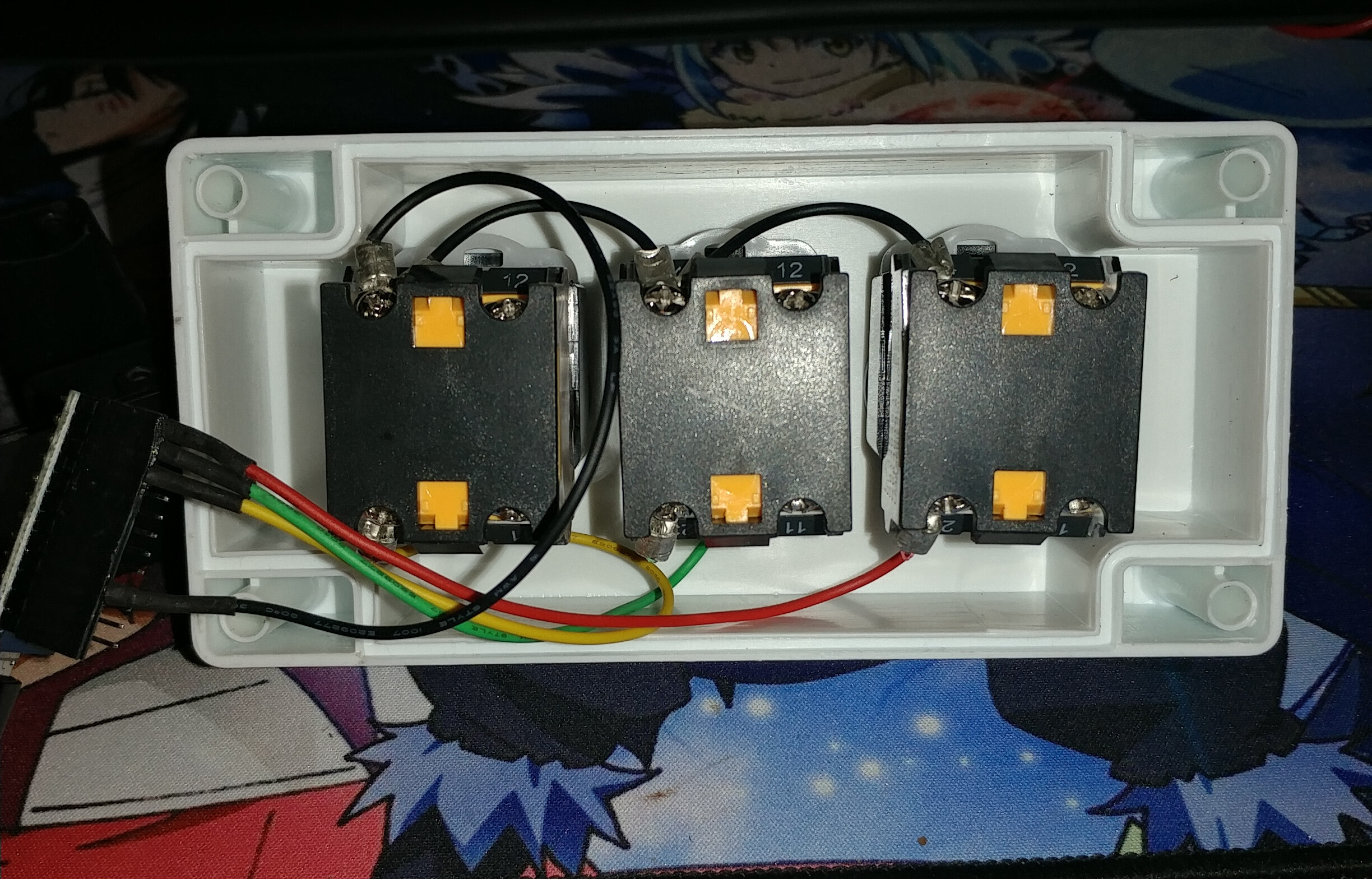

The Robot Control Buddy as I have realized it utilizes an Arduino Pro Micro emulating a keyboard and an off the shelf “industrial-style” button box from Amazon to send the Enable, Disable, and E-Stop key combos respectively. With the other bits and pieces being a USB Cable to plug into the Arduino and Driverstation, some wire to connect the Arduino to the switch, automotive terminals to connect the wires to the switches, and in my case a bit of PCB Header to solder the wire to to easily connect/disconnect the Arduino from the switches.

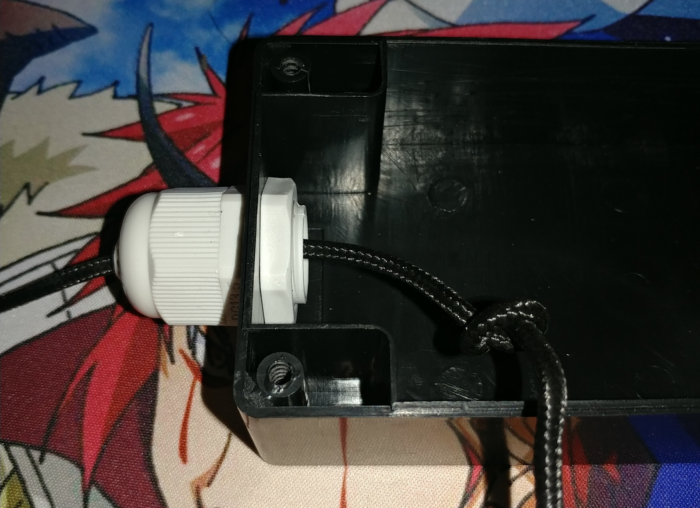

Below is a photo of the Robot Control Buddy I made, as well as some photos of the inside showing how I wired it and put strain relief on the arduino by putting a knot in the USB Cable. At the bottom is the link to the Arduino Code I wrote to have the Pro Micro send the keystrokes to the computer. Ideas for improvements as well as Pull Requests to the initial project are welcome, as are critiques.

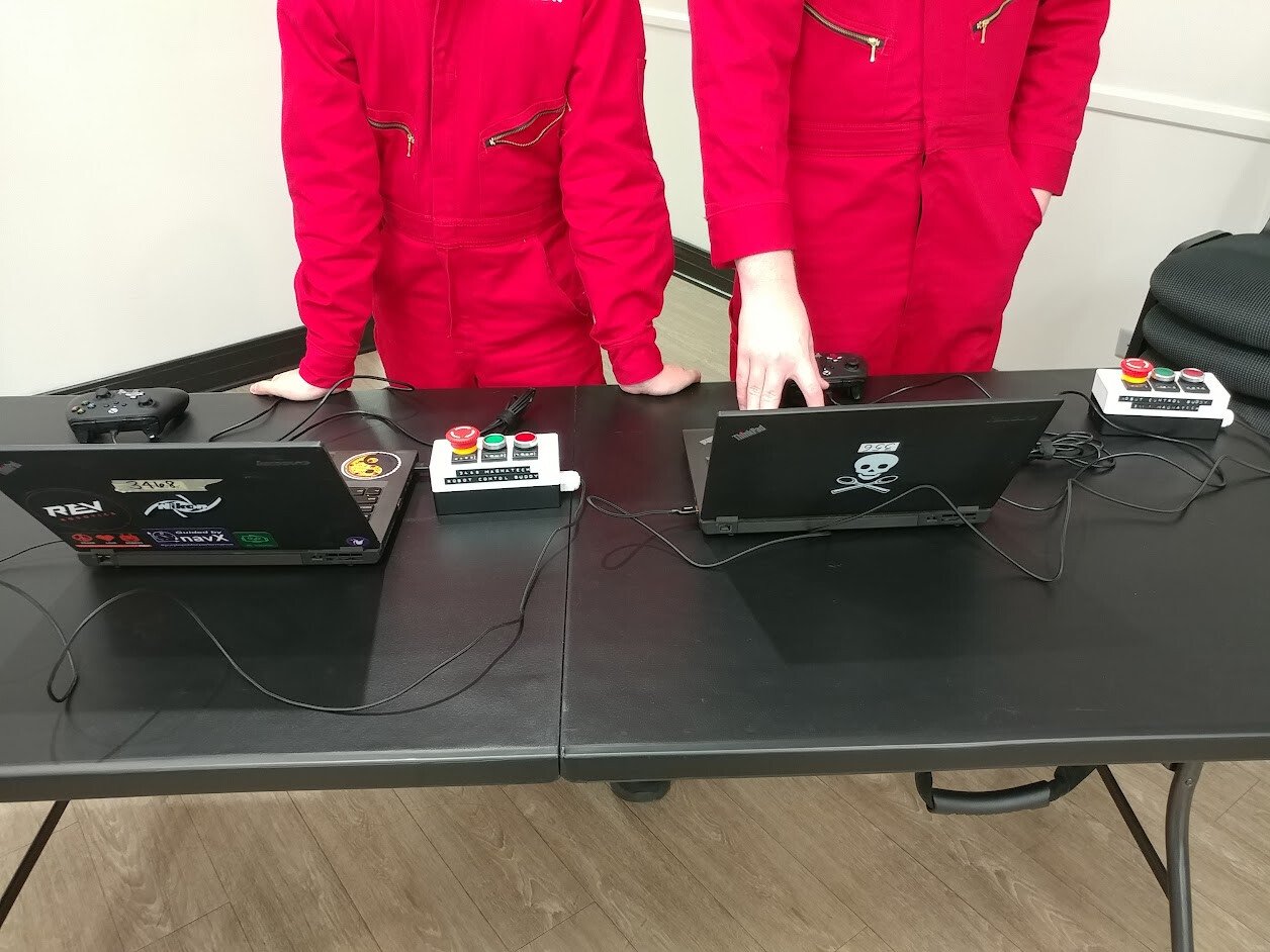

3468 gave a demo/presentation for one of our sponsors, Graphic Packaging, and we actually got comments on the Robot Control Buddies, and got to play it into our stance on safety!

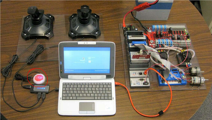

Dang that brings me back!!!
I made a very similar thing this build season with just an EStop button. Instead of an arduino I used a raspberry pi pico since it was a bit cheaper. Just bought a 3 button panel to upgrade mine now!
