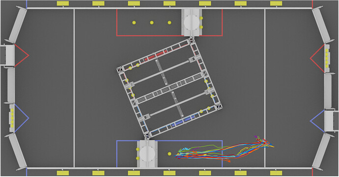

Some things ive noticed:
It looks like all auto paths are constrained to only the red side. Is this by design? This is 3476’s auto path data.

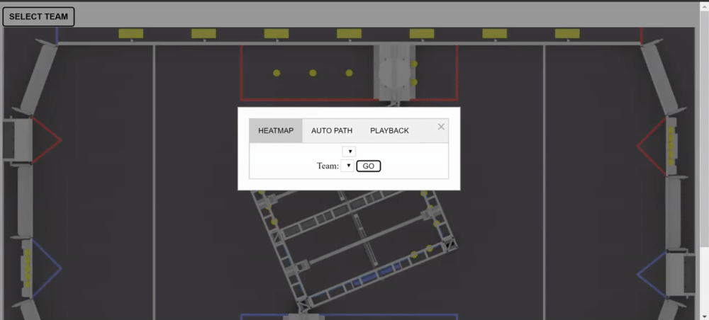

The other one is the “select team” option not working after your initial choosing, and being stuck refreshing any time I want to test something else.
I can’t click anything. Latest version of Chrome, Windows 10
Image from Gyazo
Also reported #1.
running 79.0.3945.117, no issues here. See if its an extension?
Looks like data is being normalized to red
Incognito with extensions disabled doesn’t make a difference :frowning:

Yes, this is by design. Especially with the possibility for auto routines to cross the “center line” of the field this year, it makes sense to normalize the paths to one side. This way you can also see all of the paths on top of each other instead of seeing half on one side and half on the other.
That’s what I get for releasing at 3am after making last minute GUI changes instead of waiting till the next morning to double check everything works properly. These are actually the same problem, where the overlay canvas accidentally extends to cover the menu bar instead of starting at the top of the image. Should be fixed now.

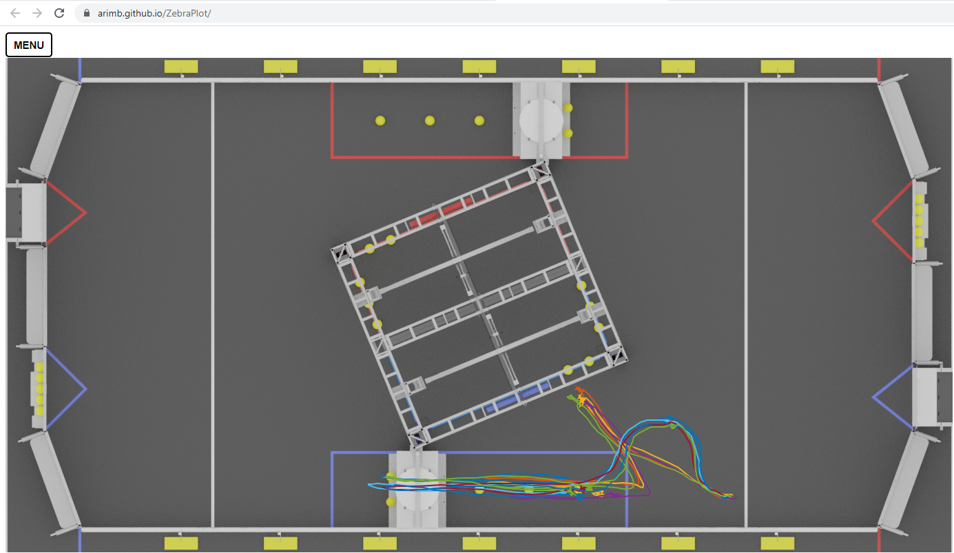

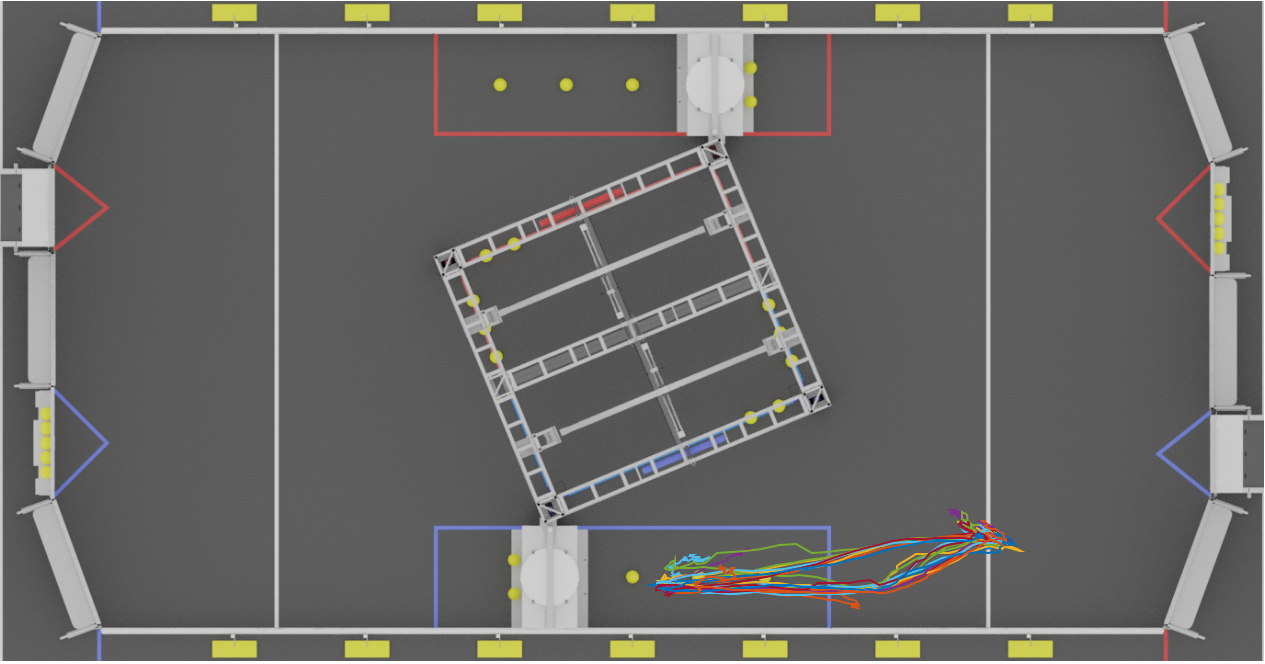

Also now that we have real data, the auto path mode looks really cool with this year’s data and true auto paths (instead of last year’s sandstorm). Here’s 1540 from PNW Clackmas, who clearly ran the same auto every match*:

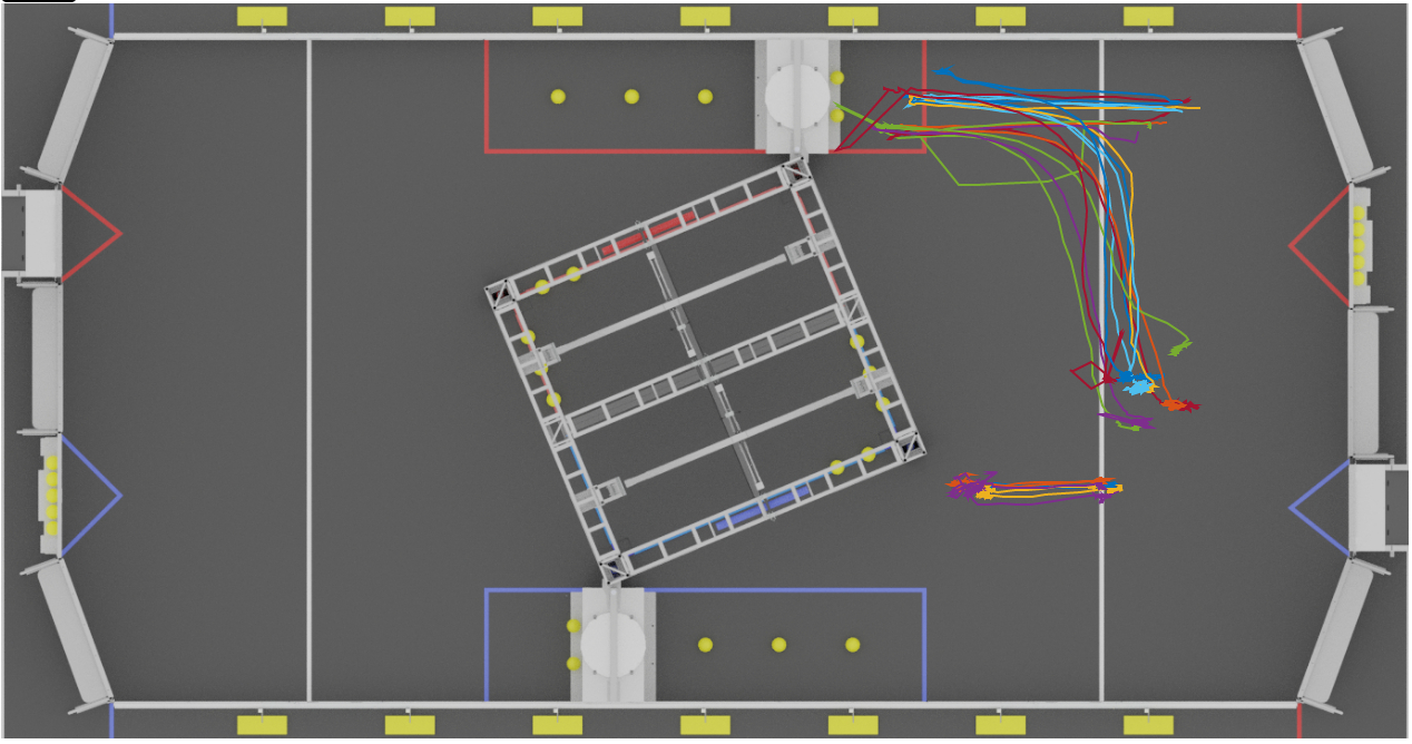

And 4911 from PNW Glacier Peak, who clearly had two different auto modes they ran:
* It looks like they may have changed their path at some point during the event
We didn’t change anything about the path. However, the six-ball auto that we ran every match grabs the three balls from the trench and then backs up (along a slightly different path) to where it started on the initiation line in order to take a shot with better accuracy. So, the bottom path is the robot going to grab the balls, while the upper one is us returning for the shot.

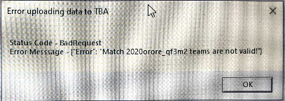

Yes and no, Data was in fact recorded but since it was a tiebreaker AND there was a substitution, our initial TBA upload attempt bounced.
There is an issue with early Glacier and Greenville events which caused some bouncy data points. We believe this can be recovered for those events and we will re-upload. This issue was already fixed for week 2 events
Can you elaborate on “bounced”? I can check the logs to see if there’s anything we should be fixing.
Sorry we got:
which appears to be related to a substitution for that match.
I don’t have a screenshot for the other but I’ll look through the logs to confirm what we got for SF1.3
Cool - here’s the code in question for that message.
Being related to backup substitutions is an plausible theory; TBA asserts that the teams in the data payload match the ones FMS publishes for that match. So for 2020orore_qf3m2 the expected teams are
$ curl -s -H "X-TBA-Auth-Key:$TBA_KEY" https://www.thebluealliance.com/api/v3/match/2020orore_qf3m2 | jq -r '"blue - \(.alliances.blue.team_keys) red - \(.alliances.red.team_keys)"'
blue - ["frc5803","frc2521","frc7448"] red - ["frc2990","frc3636","frc1432"]
