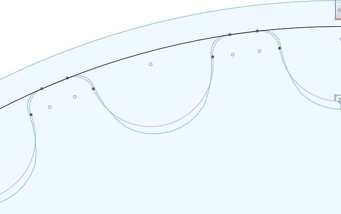

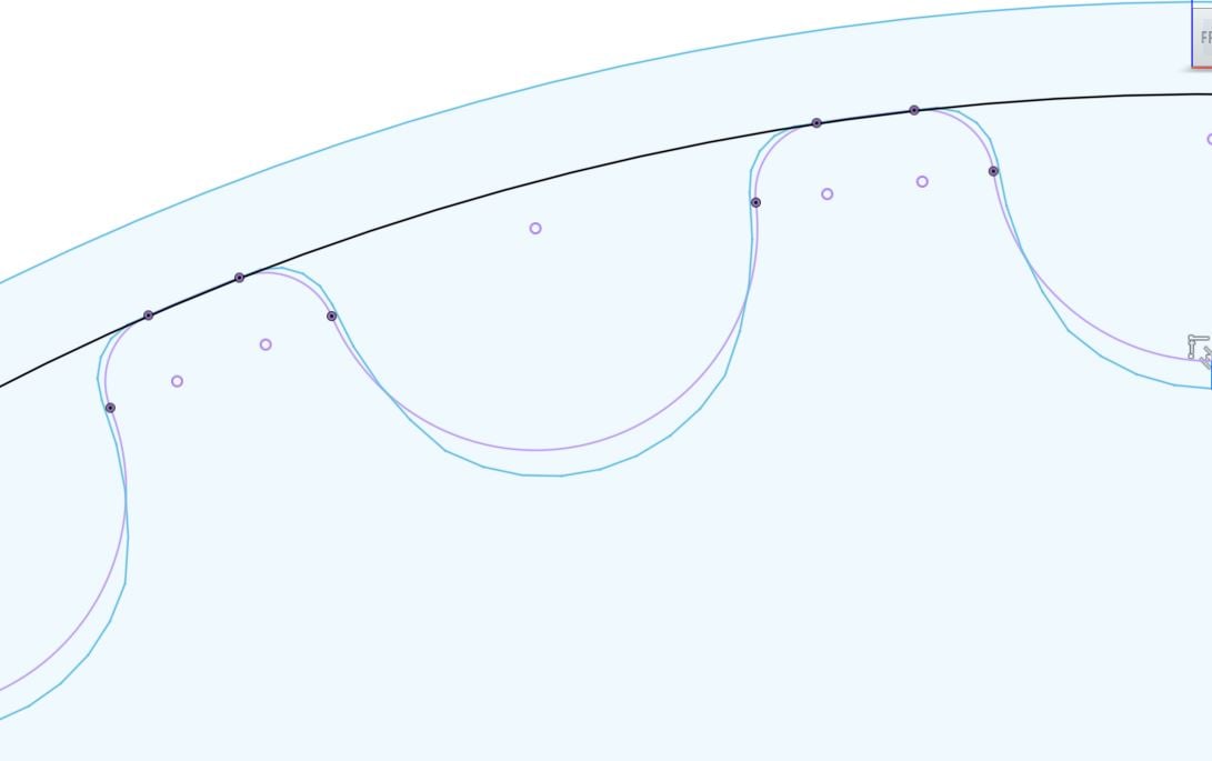

No. What I’m saying is the tooth profile is not the correct profile for a GT2-3mm pulley. It may work with the loose tolerances of a 3d printer, but it is not correct. The profile in your file has only one arc plus the fillets at the top of the teeth. The actual profile should have several different arcs. The depth of the valley is also over .1 mm too shallow.
The purple line is the profile from your file, the light blue profile was created in Gearotic. The Gearotic profile is correct, but is made up of many short line segments, so it can take a long time to mill.

So it turns out that there actually was a bug in the GT2 generator where I used the pitch diameter of the pulley as the outer diameter, that’s been fixed in the file below. That addresses my generator being shorter than the official profile.
As to the other differences: those are intentional. They make it easier to get the belt into and out of the pulley when the pulley is printed, and it has been shown to work fine by every team that has used the MKCad generator.
Pulley Generator v1.2.ipt.zip (301.4 KB)
I’ve never had a problem putting belts on or off pulleys printed from the Gearotic files. I think anyone using this generator should be aware of the incorrect tooth profile and make their own decision on whether or not to use it. I know what my decision is.

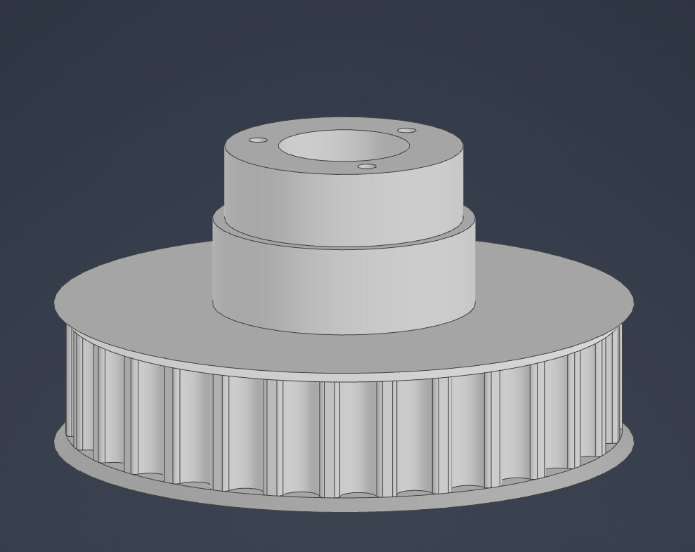

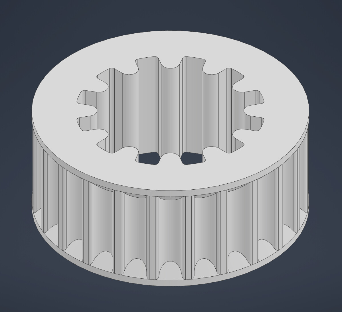

The long anticipated v2 is out! Included is a new bore option for TTB’s new insert and an option to replace the outer part of the UltraPlanetary V2 output, as well as a new style of flange designed to allow printing without supports.
TTB insert with new flanges
UP output replacement with MKCad style flanges
