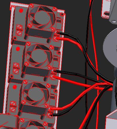

I havn’t even started with gears and chains yet and I’m not looking forward to it. I have to mess with the cable/harness feature. If anybody has any tips regarding cables please help me.

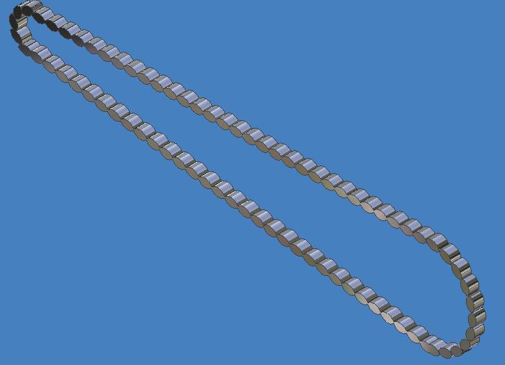

I am struggling with both chain and wires. I had XP SP2 and had to unstall it even to get any wiring to work. I think Inventor 8 pro is built of NT or somthing, beucase it donesn’t work well with XP.
As far as chain goes, I found a thread about it that had a link to download real chain. But you must constrain it link by link and then find some way of putting it on you bot. I think that some shiny and bumpy band will do it. See How much more complicated yet better looking the real chain is?
On wires, I couldn’t get real wires to route so I used segments to trace out the path then adjusted how they looked to take the place of wires.
I used the same painstaking method to make the rope we used on things

How would you constrain them so that they would actually turn when you moved the arm, or is there a way to do that at all?
The chain was for are drive system. I haven’t gotton the realish chain to fit on the sprockets right, but the fakish chain is just a static band. We didn’t use chain for are arm. If the chain you plan on using is a straight loop (like in drive and simple arms, not the expanding arms that seem to work so great), then just make a loop with the bumps like I did.
