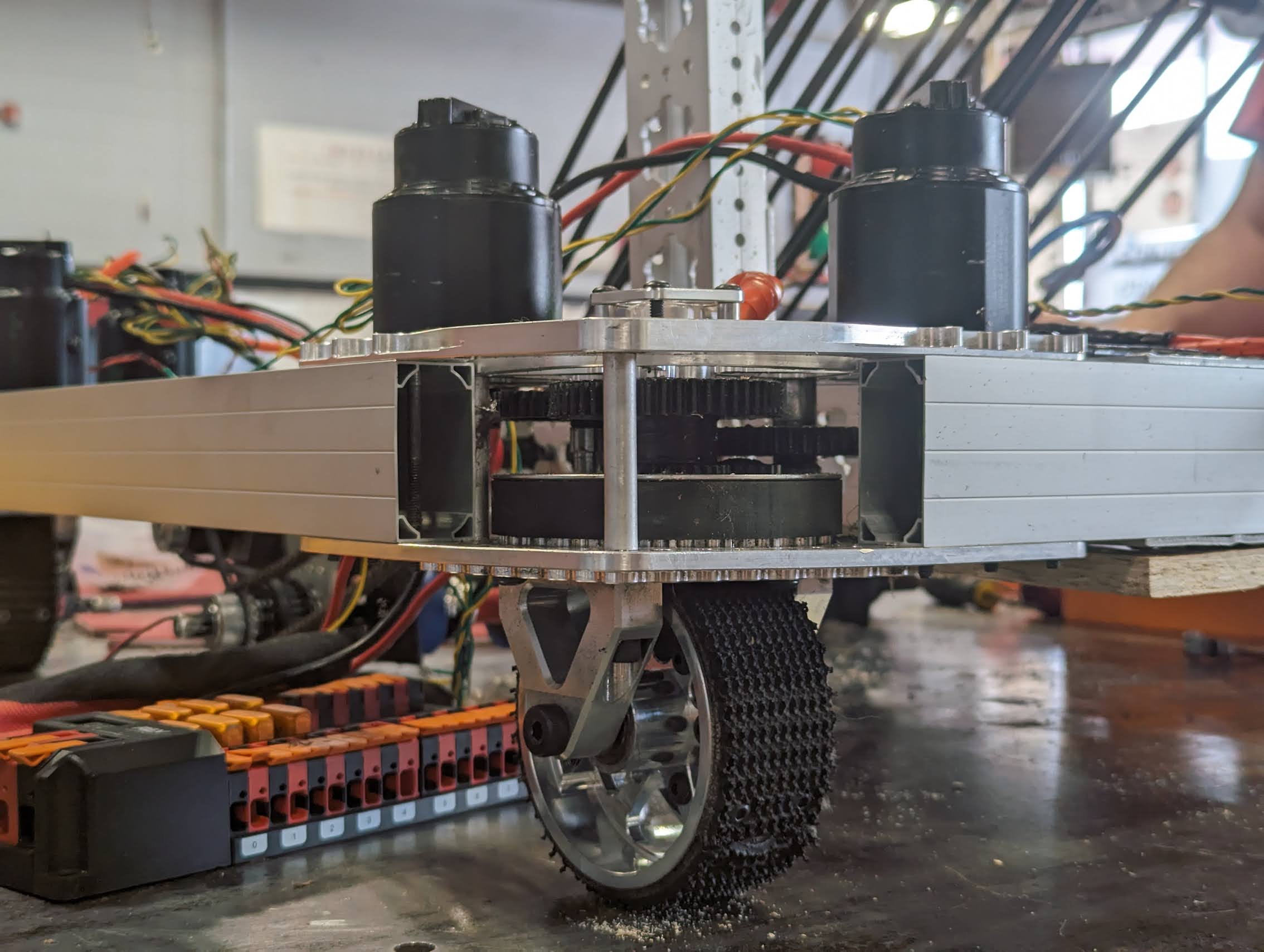

Because of the bumper restrictions this year, my team has opted to do a “below-bumper” intake. What we’ve done for extra height is moved the motors from the bottom of the modules to the top like so:
What would I have to change in our swerve module configuration code to facilitate this new orientation?

I’ve been thinking it might be as simple as adding the line:
driveMotorConfig.MotorOutput.WithInverted(ctre::phoenix6::signals::InvertedValue::CounterClock>wise_Positive);
But I don’t know how that would affect our odometry

Update:
I ended up getting the code working (finally) after about a week of searching through the program.
What I’ve ended up with is this:
driveMotorConfig.MotorOutput.Inverted = true;
angleMotorConfig.MotorOutput.Inverted = false;
So, the drive motor is inverted and the angle motor isn’t. We’ve been doing drive practice with the new motor setup and it works like a charm.
