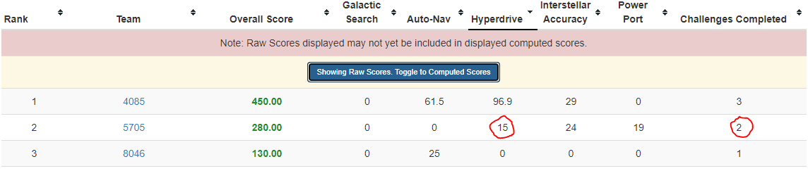

Something i would watch out for is how some of the scores for the autonav and hyperdrive challenge may be incomplete. You can upload 1 of the 4 video files and still have it added to your raw score. You can tell because their calculated score is 0 in the category and they only have 2 challenges complete. just a thing to look out for in the future.
Dope spreadsheet nonetheless

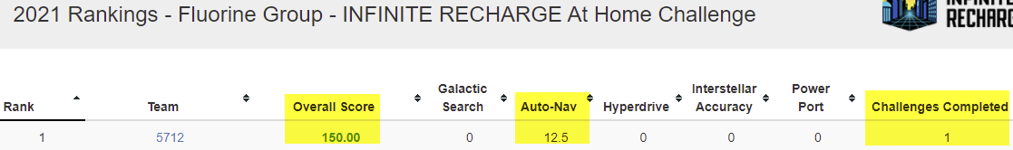

Then you have this for 5712 in Fluorine…
12.5 seconds for the sum of three paths? Looks like it’s complete and has a score posted. My concept of what is possible may have to be recalibrated if this is a complete score.

Yup. I’m checking if a computed score exists in my top and average scores logic. And just like was said, it seems FIRST has some bugs for a few teams.

Looking on their YT, it may be just their Barrel Racing one.
Looks like some bugs have been fixed or resolved. 5712 now has more values in there, and the Power Port bug (not allowing scores above 45) seems to also be resolved. The highest score is now 73.
