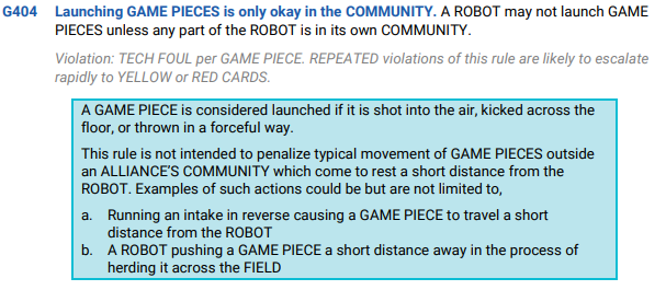

When would you ever be shooting from behind the charging station? You’re only allowed to launch game pieces from inside the community.
The community extends to the tape line just on the outside of the charging station. According to G404, a robot could stay on the far side of the charging station, poke a bumper or manipulator over the line, and shoot a game piece onto the grids.

Can’t you only shoot from the community?
Yes.
This idea was suggested to avoid having a big mechanism out of the frame perimeter and reduce DOF.
see @ash4fun reply
Shooting from the tape is legal. Abiet hard since everything can just bounce back out

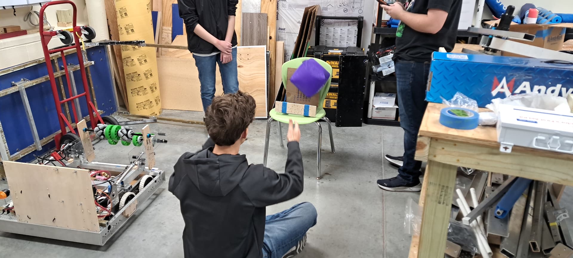

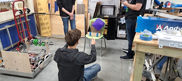

Yesterday evening, we tested “tossing” the cubes to the highest node from directly in front of the node.
The testing was done by a student launching the cube by hand. We found that the material the simulated node was made from affected the results so we quickly made a better simulation.
We tested tossing the cube in a constant orientation. We then tested the effects of tossing the cube with a flat path vs an arcing path, random orientation, with no spin vs with top spin vs with back spin and with the cube slightly deflated. Each set of tests consisted of 10 or 20 attempts to get statistically significant results.
We saw a lot of variation and inconsistencies in the results. In different sets of trials, the students got a success rate of between 40% and 70% using fixed orientation, an arcing path, normal inflation and no spin. The arcing path gave a slightly better success rate than the flat path (65% vs 60% with 20 attempts for each). With random orientation, the success rate dropped to 55% with 20 attempts. When comparing inflation, they achieved a success rate of 40% with normal inflation and 70% “slightly deflated” with 10 attempts each. When comparing spin, both top spin and back spin gave a success rate of 40% vs 70% with no spin with 10 attempts each.
We will be deciding today whether it will be worthwhile to consider tossing of the cube or if we should abandon the idea.
