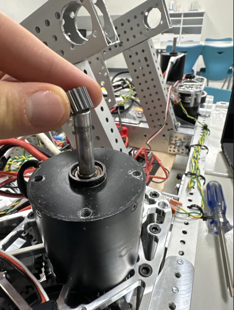

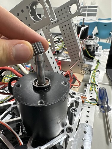

Is there a tip for getting it to fit tightly on a Neo? I find it’s too loose. I have permanent and removable types of loctite but i am not sure if that would be enough. Any insight would be great.
The above linked gear is the correct one.
There is a writeup on this different pinion gear page describing the procedure, but yes, red “permanent” loctite is sufficient. Make sure the shaft and gear are as clean as possible and let it cure before installing in the gearbox.
I use loctite 603 bearing retaining compound. It is green, but permanent and in the high strength category. Don’t confuse it with the green thread locker. The Screw retaining compounds like 271 are for looser fits. If Nathan says they work, they probably do. He certainly has more direct experience with Sport Maxes.
It is hard to get the press fit right on small parts. It seems that some of the Neo shafts are undersized.
