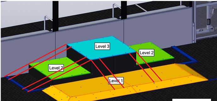

Is it possible to create a robot to work as a ramp like this?
I’m not design or cad guy but I had this idea and I wanna know if it’s possible. I think the advantage of something like this is the possibility of being a static mechanism (except for the expansion)
I mean… it’s possible. Your robot would probably be the ramp and then probably a hatch mechanism. That would be it. Also, the incline is kinda steep so some teams may not even be able to get over your bot. Making sure that your bot is also very sturdy and potentially having proof would also be a good selling point to a) have teams agree to climb your bot and b) to teams if they were to pick you for playoffs.
I measured and it’s about 20º for the first ramp and 30º for the other. Is it too steep? As I said I from other area.
You will want to be careful, because the ramp with most likely have to be pretty steep. It may be difficult creating that type of ramp without extending 30 in beyond your bot.

The major limiting factor here is probably going to be the 30" extension limit. Unlike last year, this doesn’t go away for the end game. Also remember that there are 6 cargo pre-loaded in the depot on the side there. So you’ll have to clear those out before deploying a ramp there.
And all the stuff other people said about ramps being hard for other teams to navigate, if they even agree to risk climbing it. That too.
We’re looking at this too. Consider that you can extend 30" from both sides of your frame simultaneously; if you use this to your advantage, it could significantly reduce the incline of your ramp.

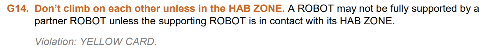

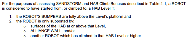

Keep in mind that you cannot support another robot unless your bumpers are fully within the HAB zone. From the side it won’t matter, but in front 30" means you have ~17" left before you’re out of the zone.
Rule citation please.
5.3 Scoring, Page: 36
“In contact with”, not “bumpers fully within”
Thanks for the correction. Then yes, you can dramatically drop the angle with a front/back ramp.
~75" horizontally from the platform to the floor will get you to 15°
As I said earlier though, keep in mind that the 30" horizontal extension rule still exists in the endgame and in the HAB zone. So unless you plan on having the ramp go through your robot, you still have a maximum extension of 30".
OK, I had some fun with this. If you can only go 30 inches out from one side of your robot, what is the narrowest robot you could conceivably design (120 inch perimeter) and what ramp degree could you get from it?
A 35x25 robot could extend to about 65 inches with a 20 degree angle (those are rounded).
If you could extend out all 4 sides that would change things. When I initially read that rule, I thought maybe it could mean 30 inches in any direction. But even with a really narrow 45x15 robot (with extendable wings! :smiley: ) to remain in the HAB zone, you’re still only down to 17 degrees.
