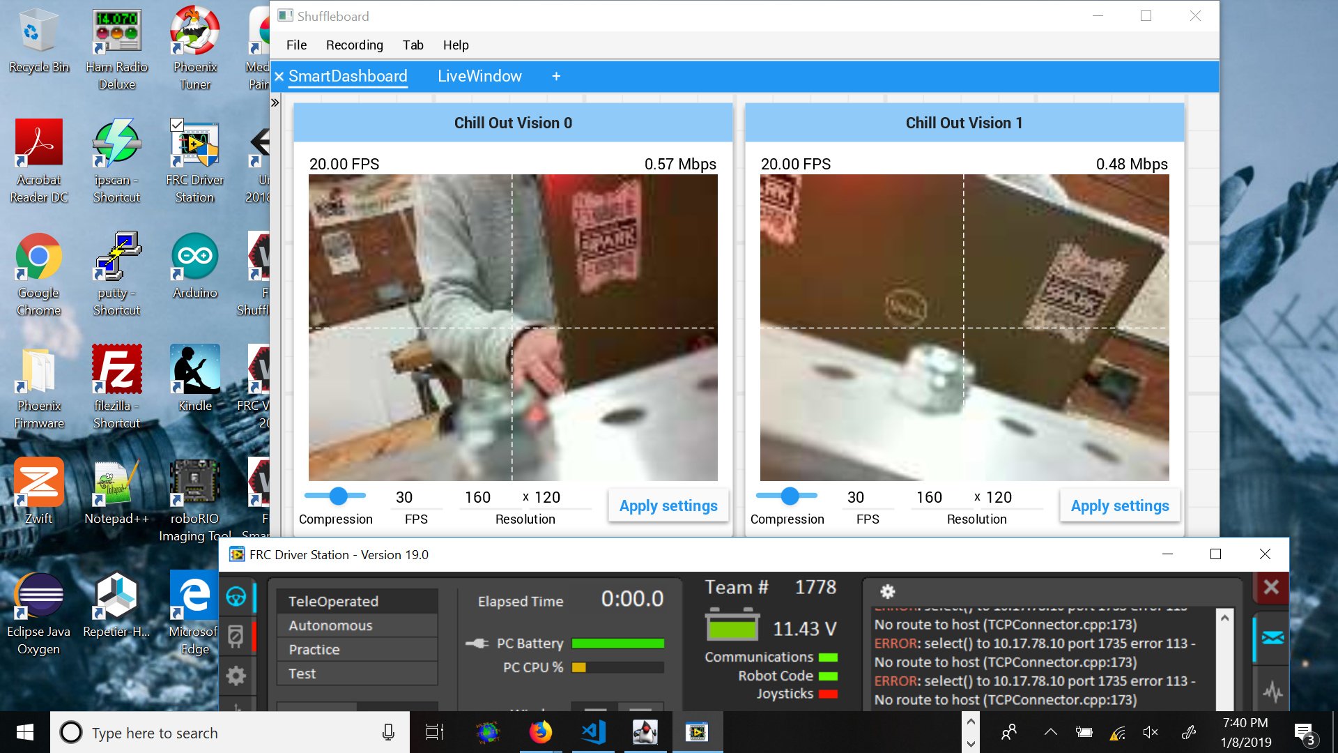

Our prototype has two HD lifecams connected via an wpilibsuite/FRCVision_pi_gen OS image (RPi) streaming to the driver station. We’ve tuned them down to 160x120 @ 20 FPS each, and are able to stay at ~2.5 Mbps network bandwidth usage. It’s a little grainy, but responsive. So it’s possible.

You should really look at the FRC-vision-rpi-gen image for RPi. You can add multiple cameras with little or no fuss, and they are available in Shuffleboard. You can also tune them in real time to ensure you are under the bandwidth limit of 4 Mbps. Here is our implementation of two HD lifecams in test.

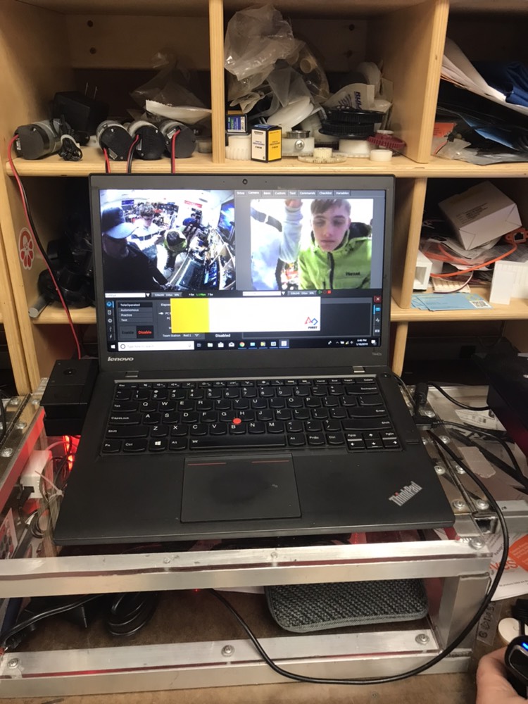

We did the same thing. Using the Microsoft Lifecam + a 170 FishEye and a Raspberry Pi. There is nothing to program, the cameras show up in the Drivers Station Dashboard and you just select the one you want in each window.
