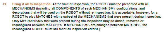

Edit - sorry, I mis-read this as removable tanks rather than a removable compressor. Yes, the inspection issue would come up.
As for removable tanks or a “pit tank”, it turns out that there are other pneumatics rules which prohibit either option.
#11
I would say the removal of a compressor would warrant a reinspection, at which point you would fall for not having an on board compressor.

I think this plus R85 would be the problem with that.

I3 doesn’t really stop you from pulling the compressor. You just cannot charge the pneumatic system without mounting it again. But. Keep in mind R89 doesn’t allow valves (other than the vent valve) in the high pressure side, so how are you going to keep are in the system with the compressor removed? The big reason for an off board compressor was to save weight. Even if you took the compressor off for matches, it still counts against the robot max weight.
