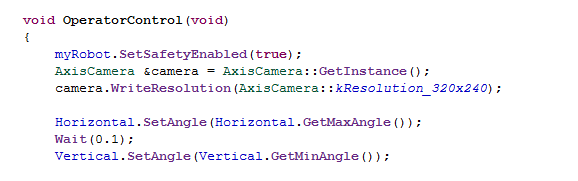

The code in the attachments does not result in a streaming video on the classmate’s dashboard. I configured the camera according to the camera configuration guide provided by FIRST.

I am having problems and I am not sure what causes them. I am running pretty simple code (in attachments).
The purpose of this test code is to
  1. Have Servos tilt the camera
  2. Have Camera Image displayed in the classmate’s dashboard
I set-up the camera prior to running the code according to the FIRST Camera Configuration Guide and had the image show to the browser during the set-up. I am using the Axis 206.
I loaded the code ( and I had the right download location specified in Windriver’s preferences). I reset the cRio and then ran teleop.
The Camera image did not show and the servos did not run.
I never worked with the camera before, so maybe it is the code error, but I think the servo code is correct.

Do you by any chance know if the camera code is not what I need to have the image display?
Thank you!
Unless they changed it for 2011 (have not checked) the code you have appears like it should work.

Are you sure you’re putting the GetInstance() line in the right place? It looks like it’s going to get called repeatedly, and I think it really should be somewhere that happens only once during initialization.

GetInstance() returns a singleton (if the same as last year - don’t have sources in front of me), so it shouldn’t matter.
OP, any chance you can post your complete OperatorControl()? Or a simplified version of such that you’ve tried and not been successful with?
