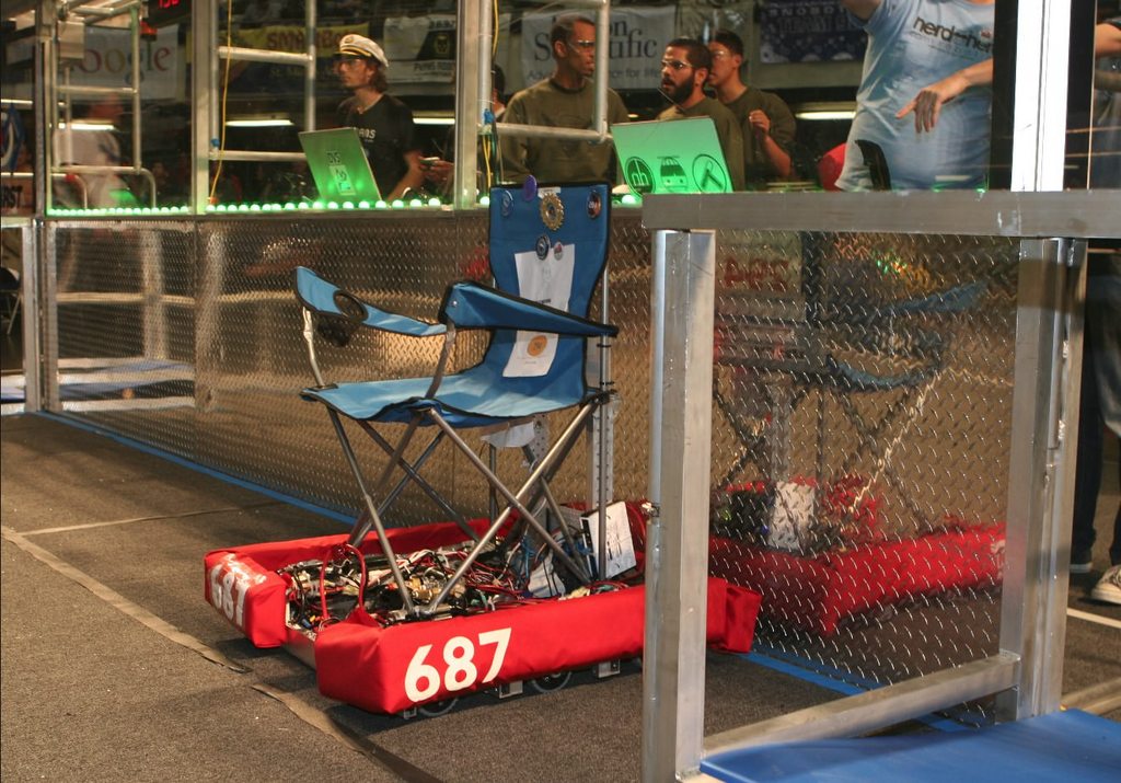

As far as keeping a robot drivetrain safe to ride on–START with the previously-mentioned teams and their specification documents for driver securement. No plastic lawn chairs allowed, do it right the first time because if something goes wrong it’s on YOU. And include full vehicular PPE for the rider.
As a case in point, I do believe that Quals 89 - Los Angeles Regional sponsored by The Roddenberry Foundation 2014 - The Blue Alliance will be VERY informative. Specifically the video, look upper right.

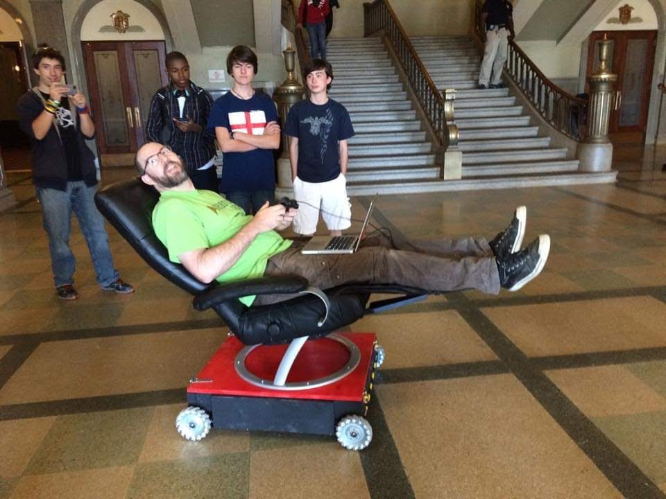

We did this nine years ago. The chair was a La-Z-Boy, the robot was fully enclosed in 3/4" plywood. We used mecanums with a very slow gear ratio and set to a low power percentage. The controller was in the hands of the rider. If I were to do it again today I would add wheel covers and bumpers.

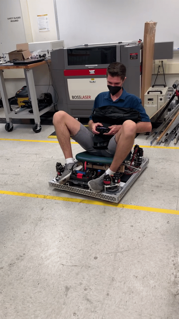

I tried it when one of those hard plastic school chairs broke and the seat became separated from its metal frame. It was promptly zip-tied to a swerve drive base we had lying around. Was extremely jerky due to the standard robot acceleration/deceleration parameters still being used. Humans don’t like the g-forces as well as the robots do, so you had to have a very light touch on the sticks.
Things went pretty well until I got a little carried away with the donuts and the zip-ties snapped, causing the chair to tip backward and nearly crush the RoboRIO. Thankfully it didn’t.
Also note that we did at least try to be safe about it. Someone volunteered their belt, which I strapped around myself and the chair, to keep me from flying off the thing. Anyway this is the moment the zip-ties snapped and we put this idea to rest:
