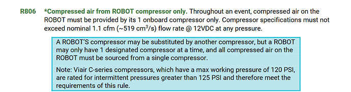

Is the andymark 1.1 pump still allowed?
it seems like the cfm limit is 1.1, so it should be allowed, yet in previous seasons I was told the andymark 1.1 pump was not allowed. It seems like it is within spec, so I don’t see a reason why my team couldn’t use it. we have a spare one from a while ago, and it is the perfect size/power for our usage.
If it was in-spec for that season the inspector was likely mistaken; many think the Viair 90C is the only legal compressor. No issues using it now provided all the other pneumatics rules are followed.
