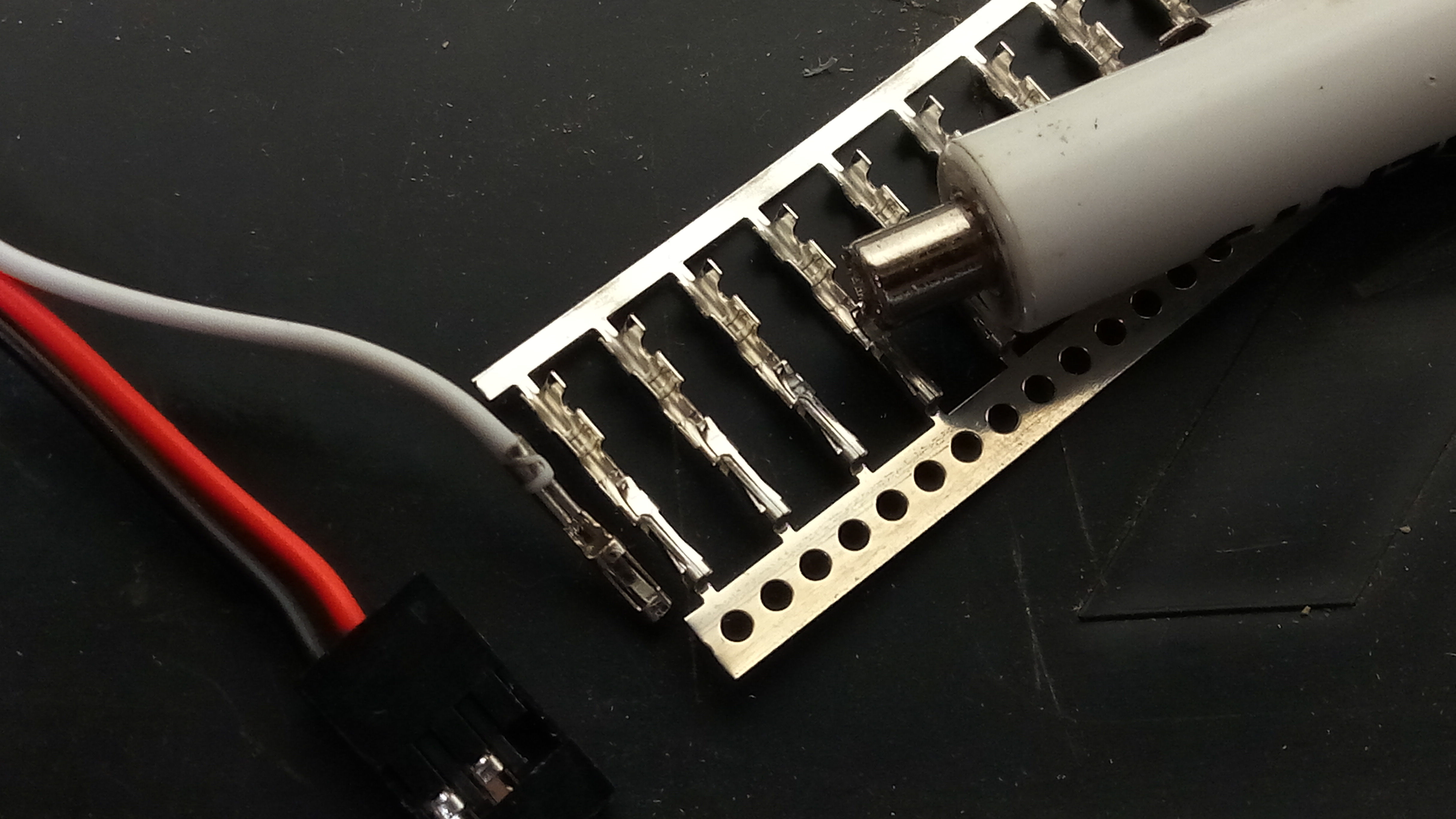

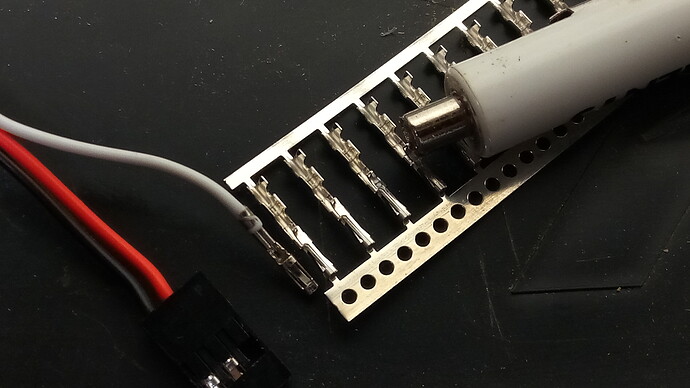

Similar yes, but not the same.
We use Anderson Power Poles for all major electrical connections on our robot. They’re like the battery connectors but smaller and easier to crimp.
The Molex crimp pin is longer. Here they are side by side. So not exactly interchangeable.
