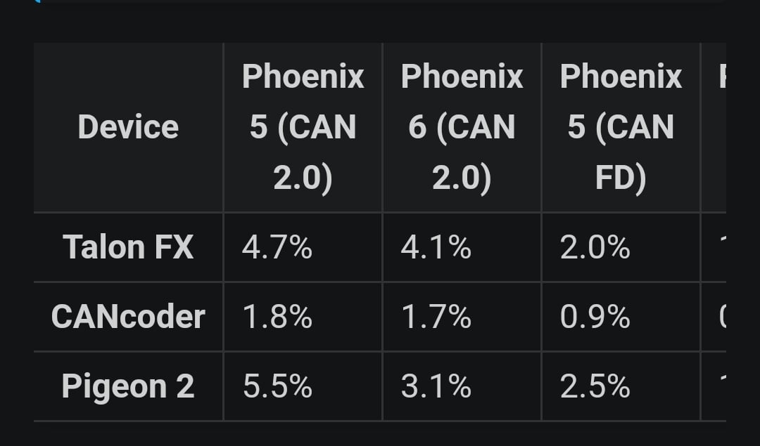

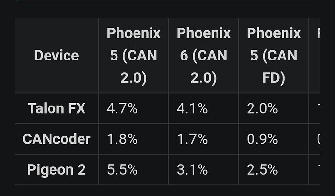

+1 to this. I actually prefer 2.0B because it’s more tolerant of weird wiring. Looking at CTREs chart below, 20 Falcons, 8 CANcoders, and a Pigeon only uses 114% of the bus on Phoenix 5 CAN 2.0B. Divide that into two busses and bam you’re under 60% on both with no optimization. Plus, even though their FD uses a difficult-to-support 10Mbps CAN, the utilization only goes down by a bit more than half anyway. Frankly I would have preferred an open use 4Mbps FD bus, if FD was desired, so that cheaper modern MCUs that support FD would work with it.
