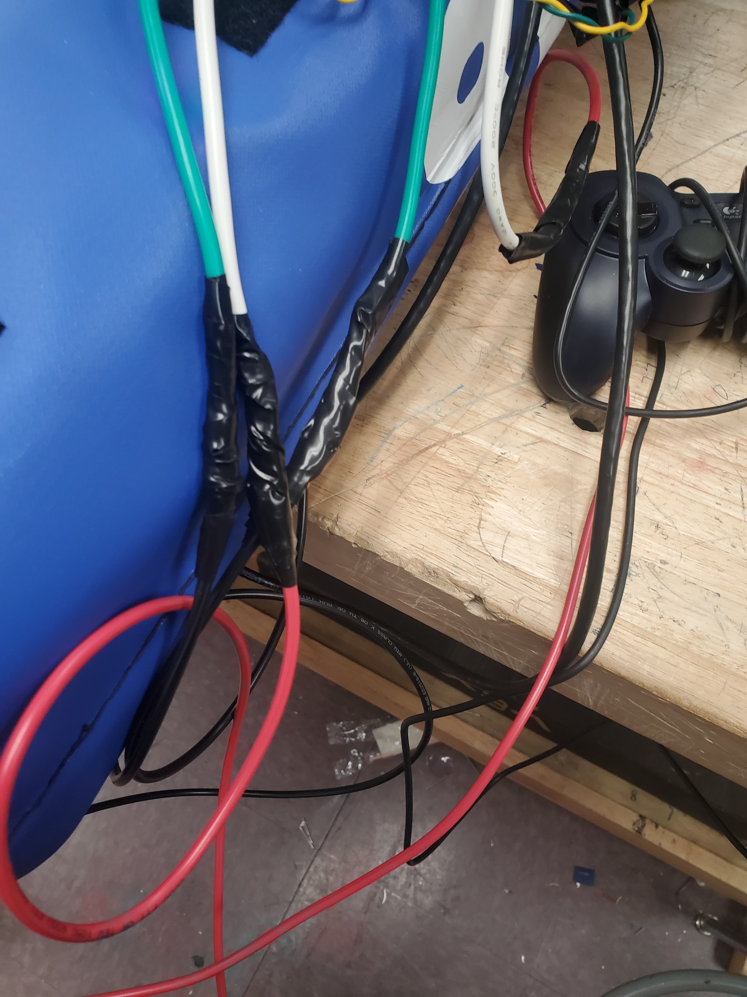

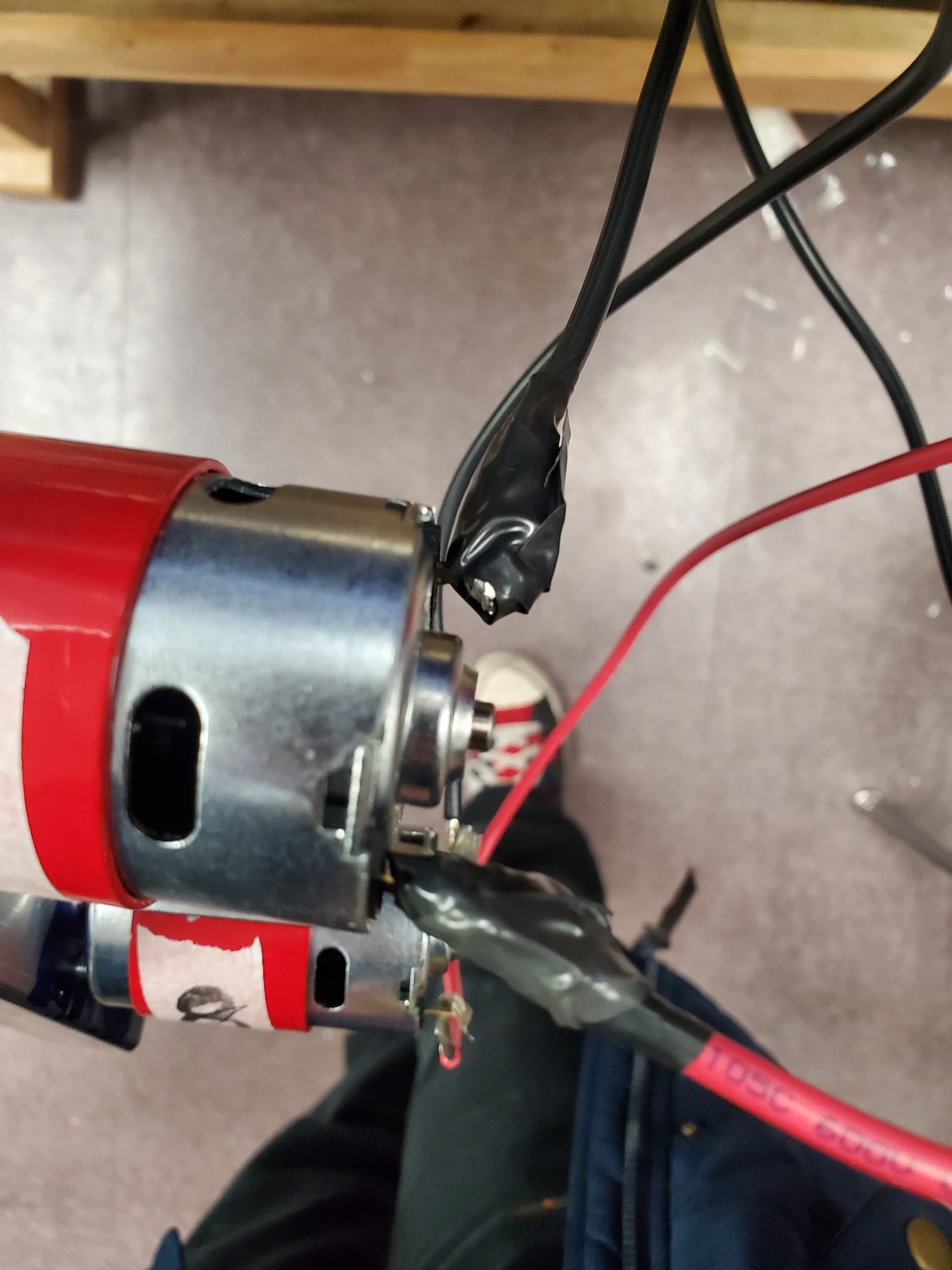

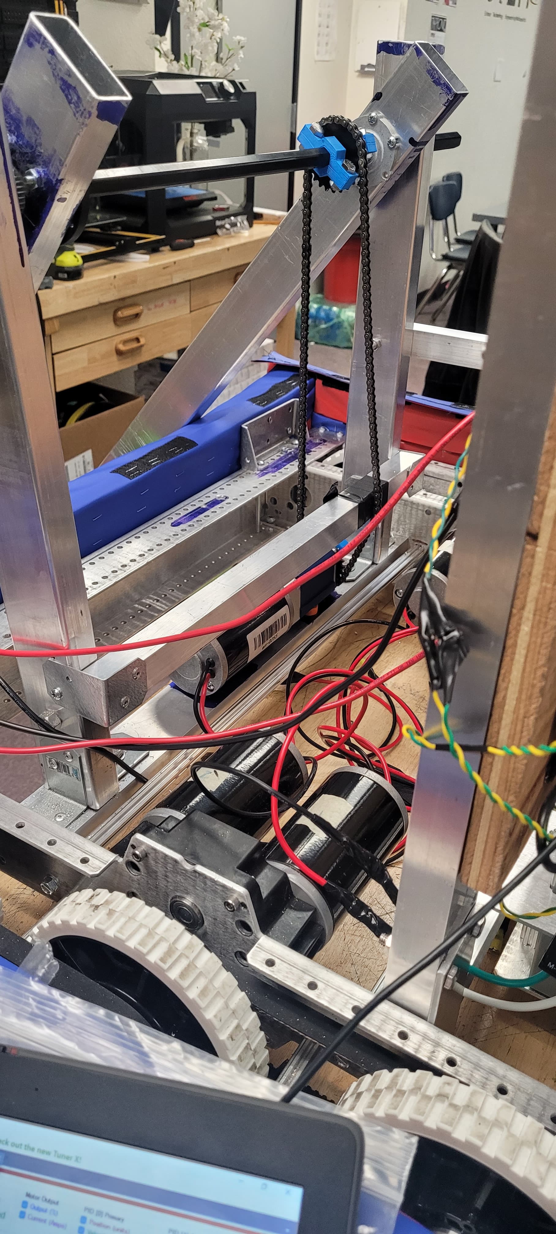

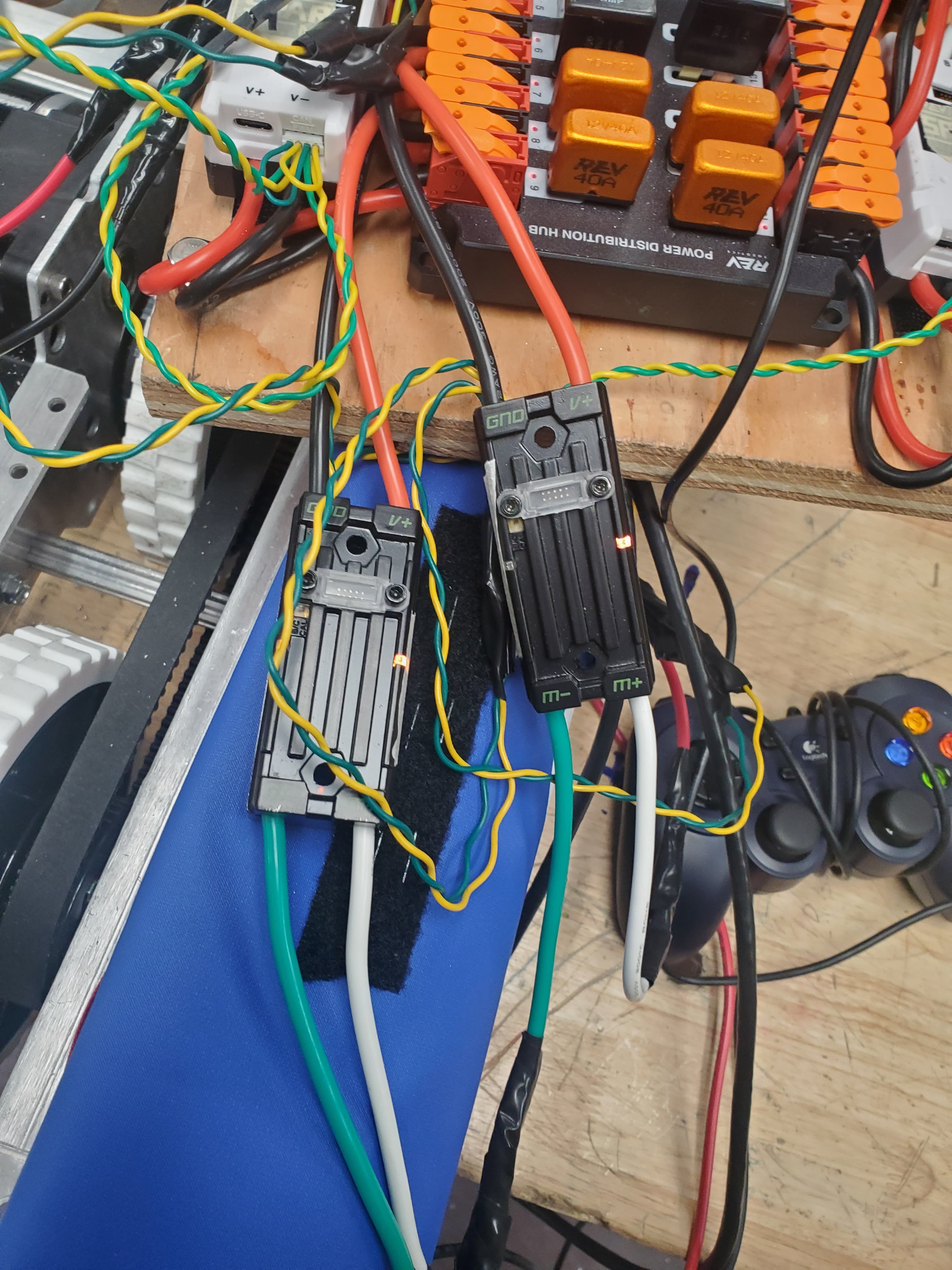

Hello this is team 9172, we connected out motor controller to our red line moters and we aren’t sure if there is an issue with how it was connected. Put motor controllers are blinking so we think they are connected but we arent sure.
In the second picture it looks like you probably have a short from one of the motor terminals to the case. This is bad. Also you really should insulate those terminals in general with heat shrink or electrical tape. I would redo those connections.
How can we fix the short? Also what is the motor terminal and case?
The motor terminal is the little metal tab where the wire attaches. The motor case is the metal part of the motor. In the photo the two metal pieces are touching, thus it’s a short. You need an insulator - a non-conductive material like electrical tape - in between these two metal pieces to prevent them from shorting.
The reason I’m saying redo those connections is the soldering also doesn’t look like it’s fully penetrated the connection, so it probably doesn’t have a good electrical connection. You’d need to cut off the wires, clean the terminals, and solder them again, this time keeping the stripped portion of the wire only as long as necessary and keeping it taut/seated in the hole while you solder it, so the solder can fully wick onto both the tab and the wire.

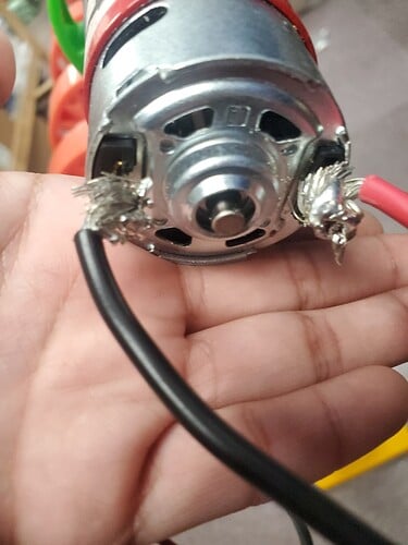

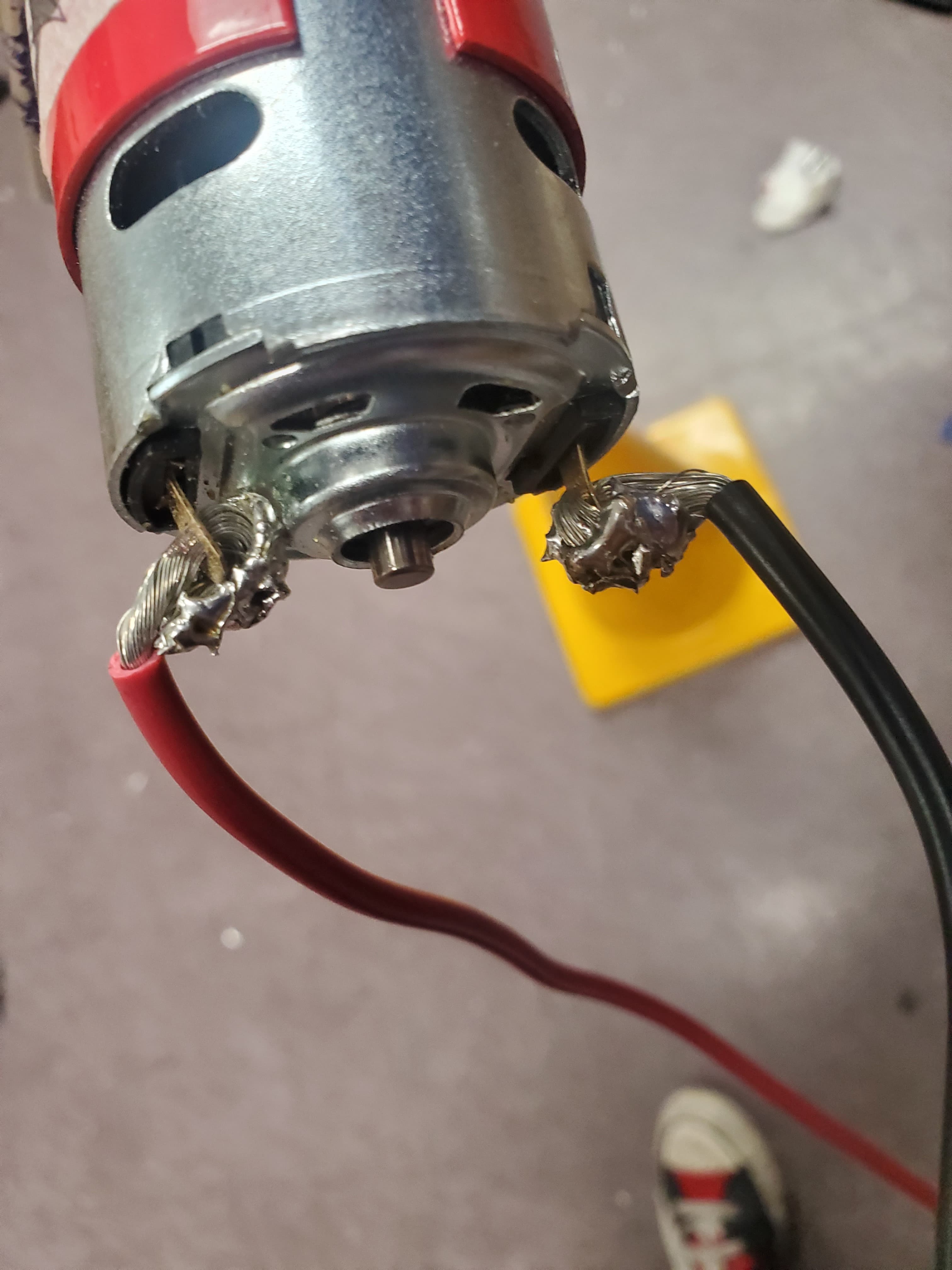

We re did it but the motor still wont move :l helppp :pensive:

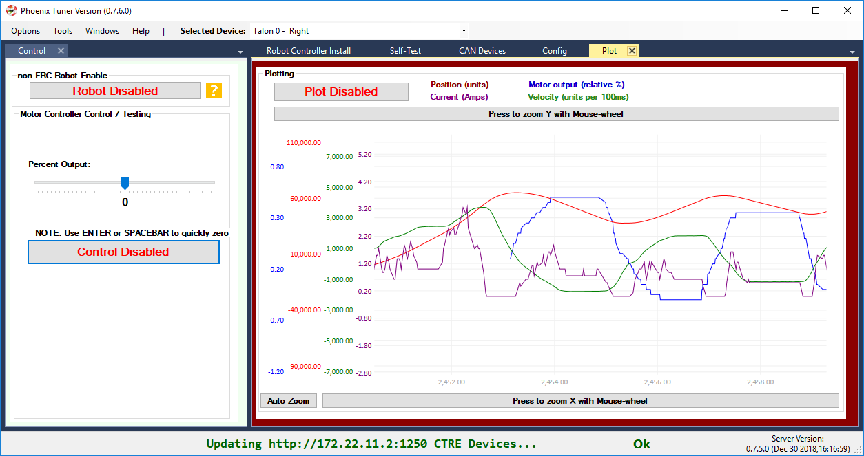

  • The Phoenix client also has the capability to test-drive the motors, so I would try that as well
I would recommend you follow the “Bring Up” tutorial on CTRE for the Talon SRX motor controllers: Bring Up: Talon FX/SRX and Victor SPX — Phoenix documentation

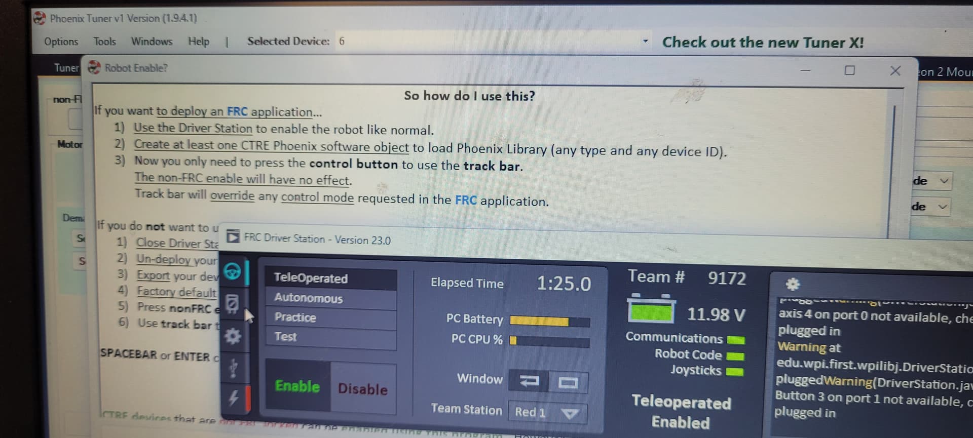

How can we test drive on the phoenix turner client? Where do we go specifically?
What/where is the control button and track bar on the driver station?
They’re in Phoenix Tuner.

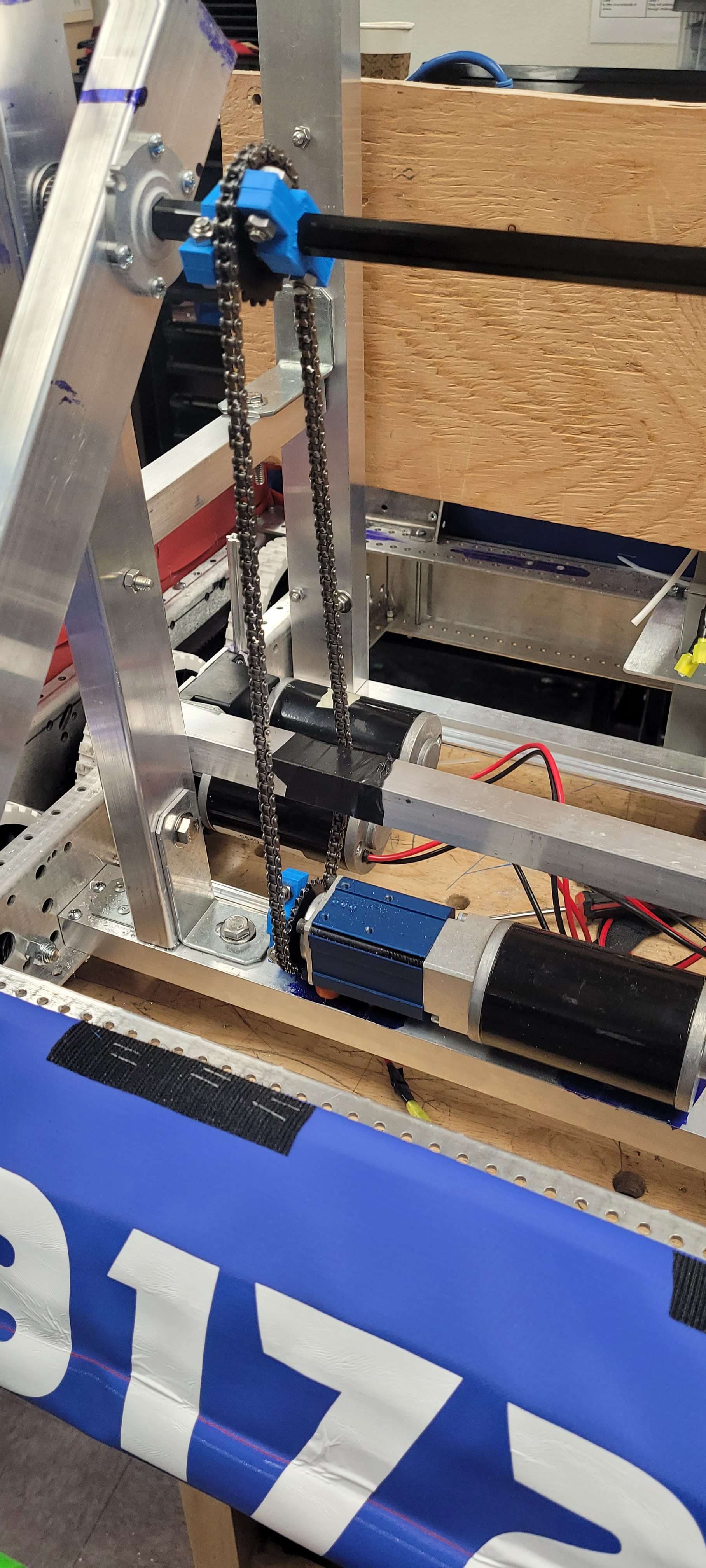

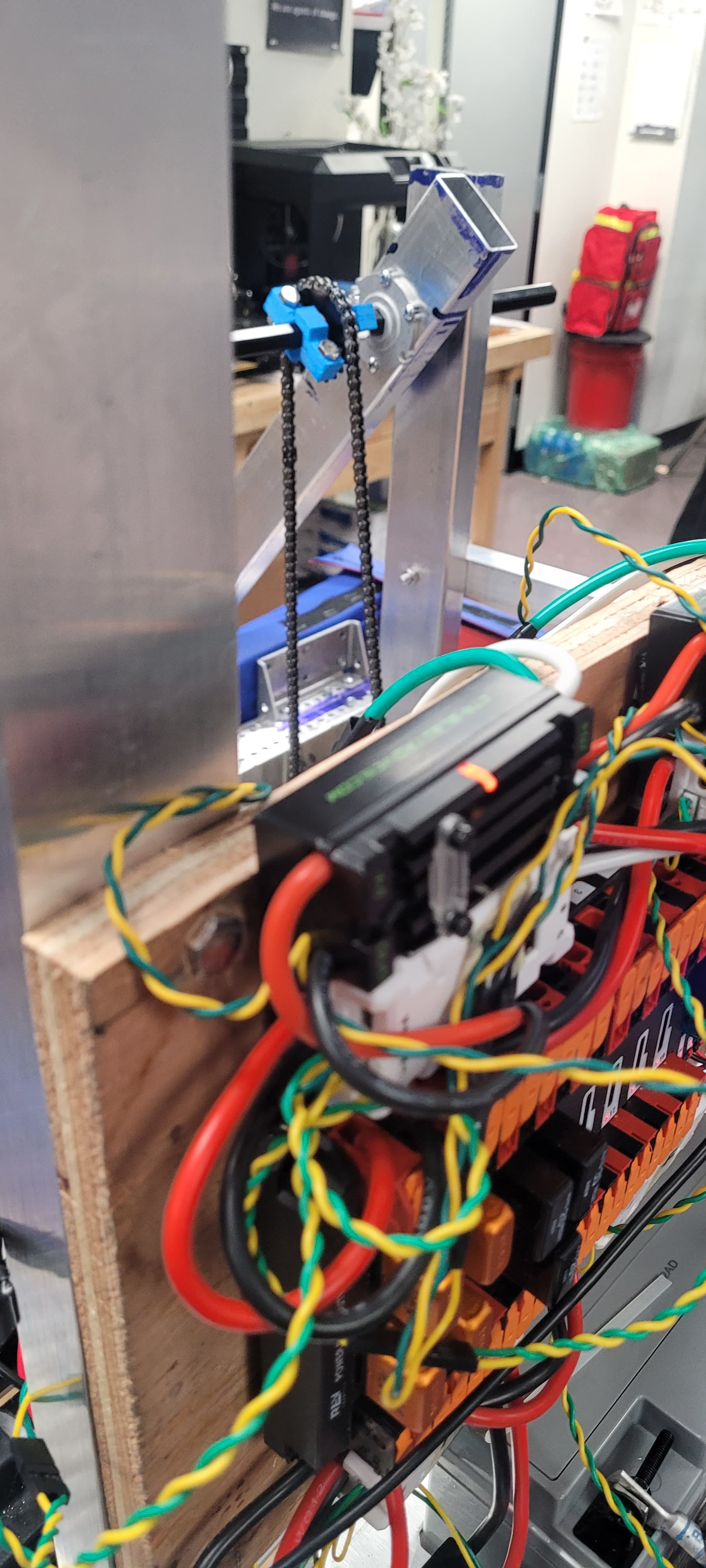

Thank you everyone! For the help and support right now the motors work but we have just 1 more issue and its our chain, it isnt able to lift up the arm and we dont know how to solve this issue
From what I can see it looks like you’re jumping the chain on the bottom sprocket, do you have anyway of shortening your chain to tension it more?
You also might just not have enough torque so it’s not strong enough to move it, if that’s the case you could use some springs from a hardware store to try and counterbalance the arm some.
