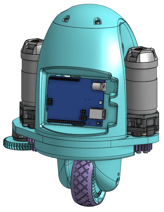

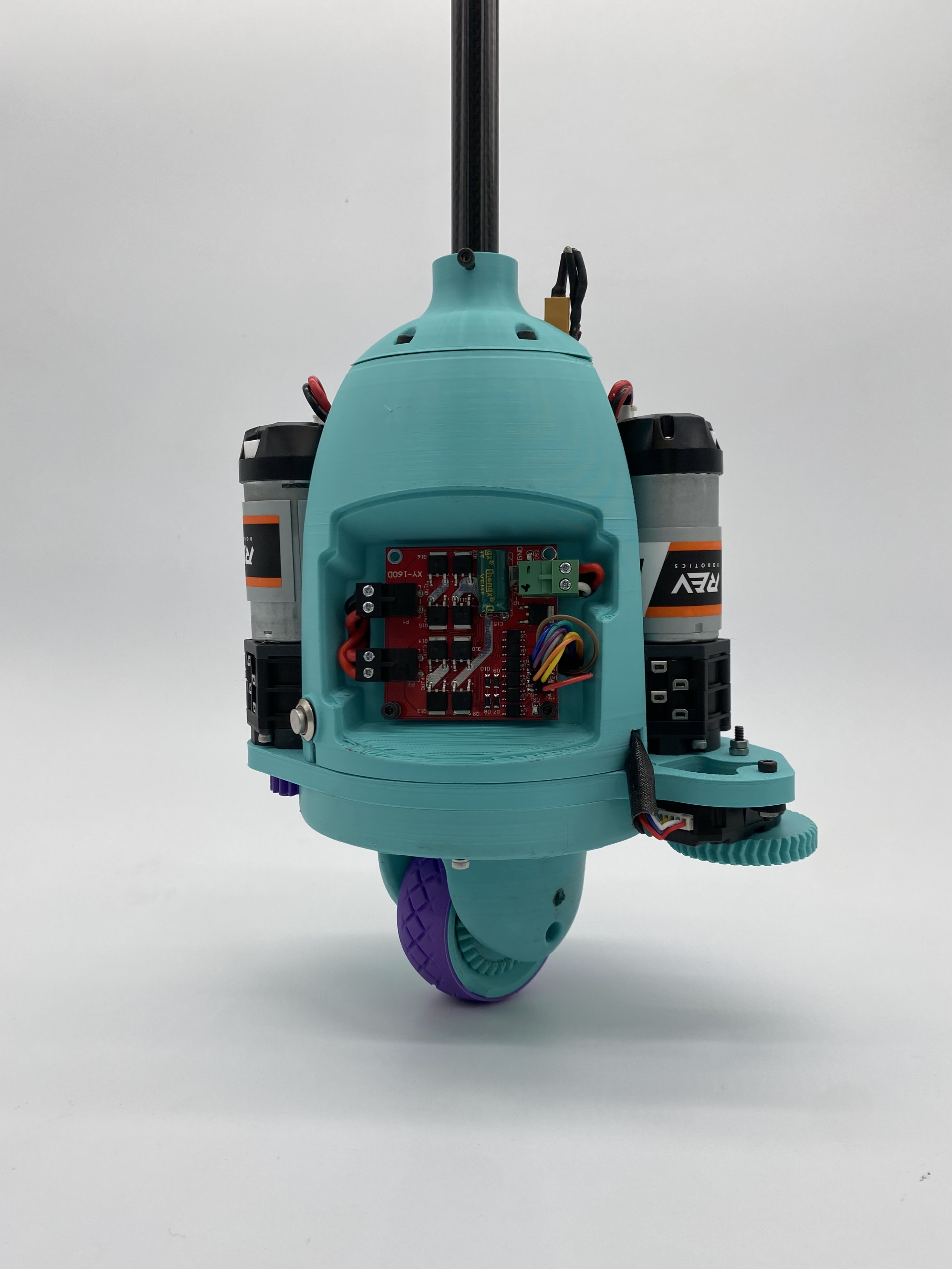

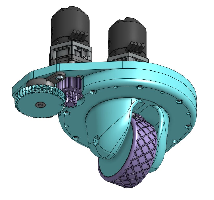

I’ve been iterating the design for the past 4 months or so for a separate project, and have since made it way more viable for FRC-related testing. It’s been assembled, iterated, tested, and it works really well.
Here’s a link to the updated design, and here are a few teaser shots:
Of the module in it’s V2 form…

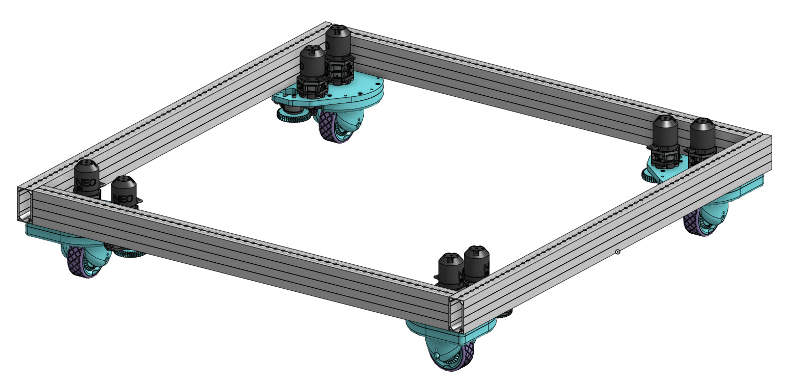

Of my project… TippySwerve (chief post coming soon)

I don’t have a BoM just yet, but poke through the CAD, you should be able to see which parts are which, and what you’ll need to buy.
Without going too in-depth, the hardware you’ll need is:
  • 2 types of short m3 bolts (m3x15 and m3x20)
  • Long m3 bolts, for gear and wheel axles (m3x35)
  • m3 nuts
  • some m3 ID bearings, 12mm OD if I recall correctly, but check the cad on that one
  • 6mm airsoft bbs
  • rigid 3d printer filament (I used duramic PLA+)
  • flexible 3d printer filament (I used overture 95a TPU, it’ll print great on a stock ender 3 or similar bowden setup)
  • rev thru bore encoder
  • drive and steering motors with ultraplanetary gearboxes
The main cost drivers are gonna be the last two, but the above items should run less than $20 per module, assuming you build 4.
I’ll post a proper BoM when I post my project overview, but don’t wait up for that.
Assembly should be very straightforward. If you decide to build one please DM me or start a new thread; I’d love to help :slight_smile:

I read about this as well, it’s pretty neat. I don’t think you’d get the real benefits of metal printing, though, which is stiffness and layer bonding.
Short of carbon reinforced stuff like from a markforged or SLS printer, most of the data I’ve seen shows PLA+ to be the next best structural option (in stiffness and durability). There’s less data comparing filament types for gears, both for strength and lifecycle wear, though.
I’ve put this module through the ringer with all PLA parts and have yet to have a material failure. The geartrains have all been strong enough to hold stall torque without shearing or flexing. I’m using pretty weak motors, though, and my load cases don’t really mimic FRC play. I’m most worried about the bevel gear for drive, it has kinda thin walls and could flex or shear.
